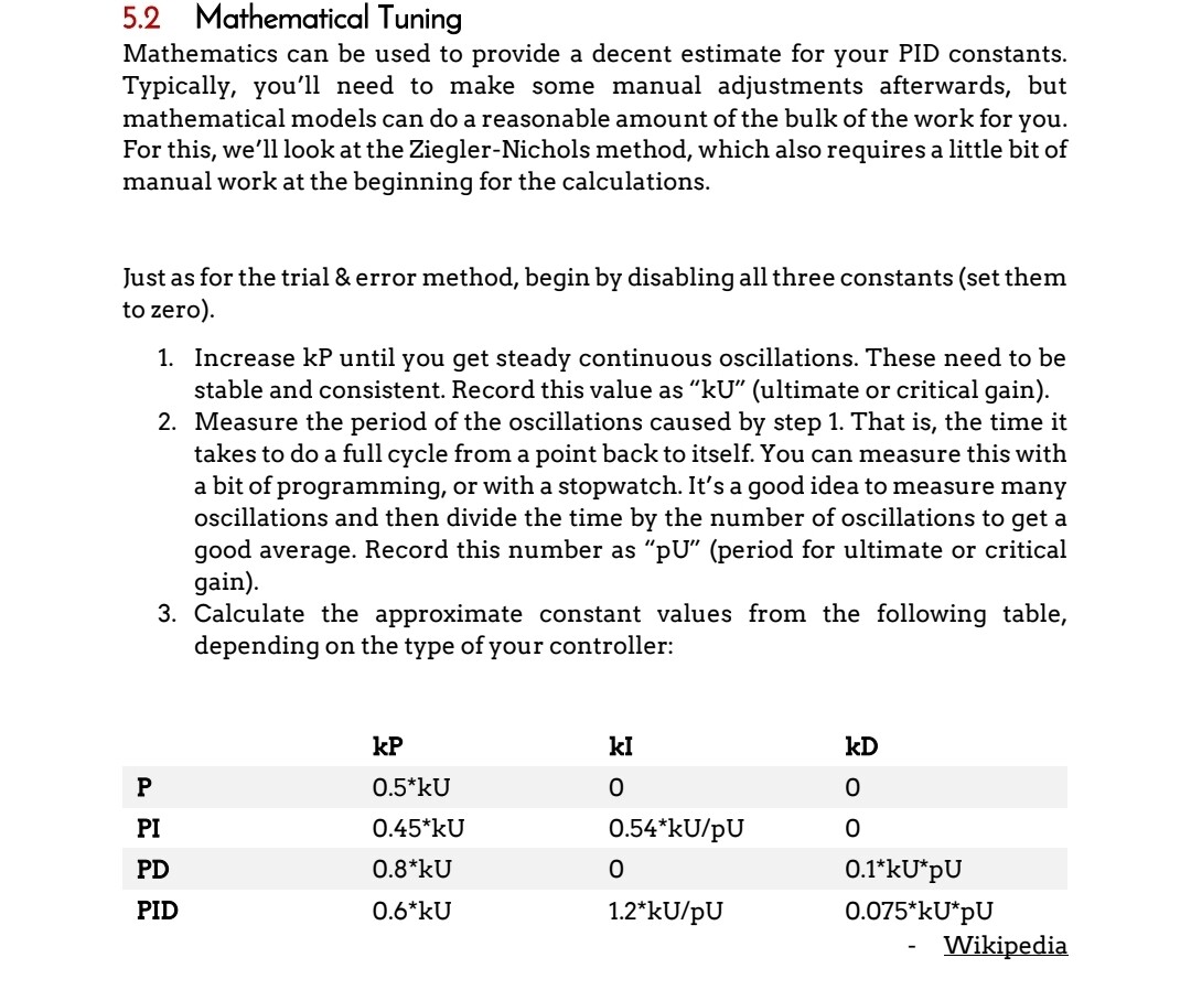

This document has lots of tips on tuning PIDs
introduction_to_pid_controllers_ed2.pdf (400.2 KB)
The above document contains a good description of a mathematical tuning method called the Ziegler Nichols method
I know this kind of deviates from the scope of vex robotics, but the tuning he does in this video is very useful.
The task is essentially the same as yours, just using gyroscopic motion instead of (presumably) wheels on a surface.
He uses some tricks beyond basic PID to tune the balancing and gets it to be particularly effective, and the code is shown (but not really explained) in the video. You might consider taking some of his ideas and adding on to what you have already.
