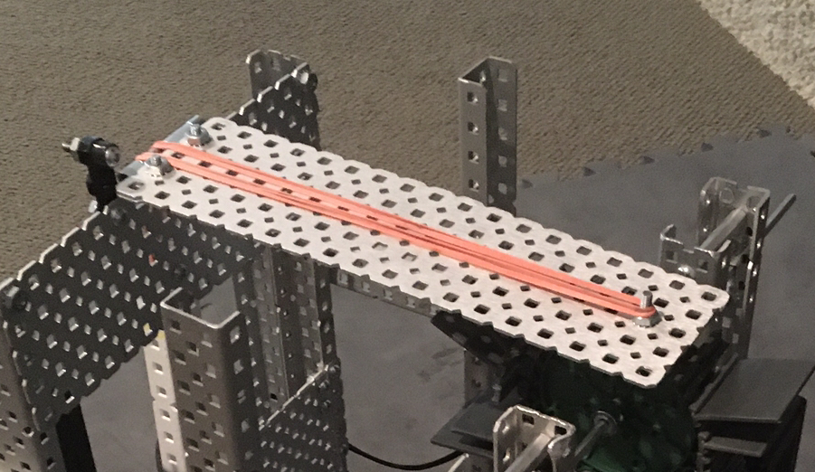

Our teams hood is very simple, but it works.
The idea I had was to have the flat plastic material as a latching mechanism, and the first ball pushes it into the locked position.
You could also use 9MotorGang’s design, and use a rubber band that is released when you move a wheel or gear. That is what we did for our iq conveyor
Is the flat bearing the stop for the hood? If so I suggest switching it out as the plastic will slowly start to bend.
It is to stop the hood. That is an old picture and we have since modified it. We are are building from home and have limited parts.
