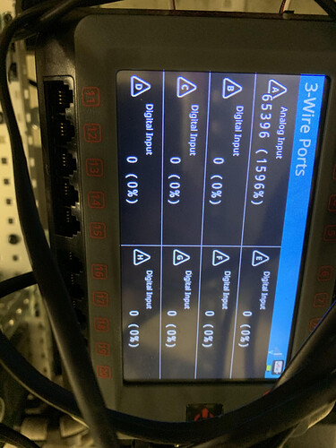

i was programming for my 3 different teams 785B E and Z as team A has their own programmer and the team decided using a gyro sensor in order to get more accurate turns would be better for competitions while programming the first bot i got the code to work fine the gyro is working and nice but the second bot the gyro sensor doesn’t stop counting up one problem i did run into was the fact i was translating old code I wrote last year from robotC to C++ for VCS i used absolute values and a lot of voids just to make things easier in the long run even after the is calibrating the gyro still continues to count up

@stonedagger the problem with gyro counting up, usually occurs when robot starts moving before gyro calibration is done.
Take a look at the vex Gyro API: https://www.robotmesh.com/docs/vexv5-cpp/html/classvex_1_1gyro.html
The correct usage of isCalibrating() would be:
void preauton()
  while(Gyro.isCalibrating())
    vex::task::sleep(1);
this stopped the counting but now it isn’t even moving and giving a value of 65534
First of all, make sure that the wire is fully inserted into 3-wire port and connected to the Gyro with proper polarity (black wire is Ground).

V5 has a quirk, where reading values of sensors, connected to legacy 3-wire ports (analog and digital), were returning 0 if you try to read them right after V5 startup.
So if you are trying running autonomous right after program starts you would need to delay reading those sensors for a short period of time to let it properly initialize.

ill try this and see if it works thanks for your help
it worked thank you so much :smiley:
