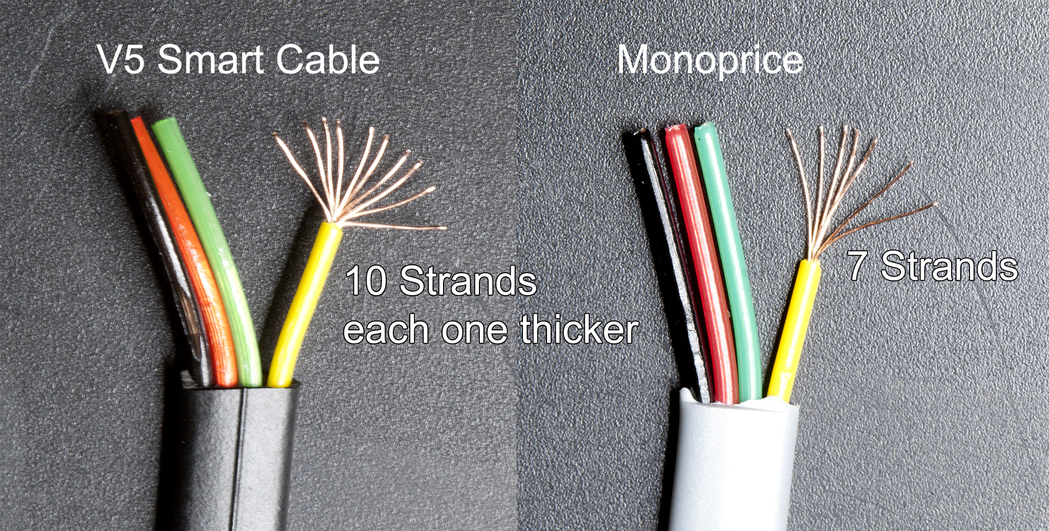

I saw your post and had a weird question: is the new cable from VEX your basic 4-wire RJ45 phone cable? Because I have a ton of the stuff at home from old phone projects.
take a look here.
No issues that I have found.
we only use V5 cable, and it works well for us and the stock is pretty cheap - no issues with the cable, just the crimping tool
Ah thanks. I wondered about that. Would my old school RJ45 crimping tool work with V5 cable, I wonder?
Anyhow, I asked only because it “felt” like some of the phone cable I had (there’s the thin stuff – I suspect that is what you have in the picture – and slightly heavier-duty wire that was a different brand I also got once),
