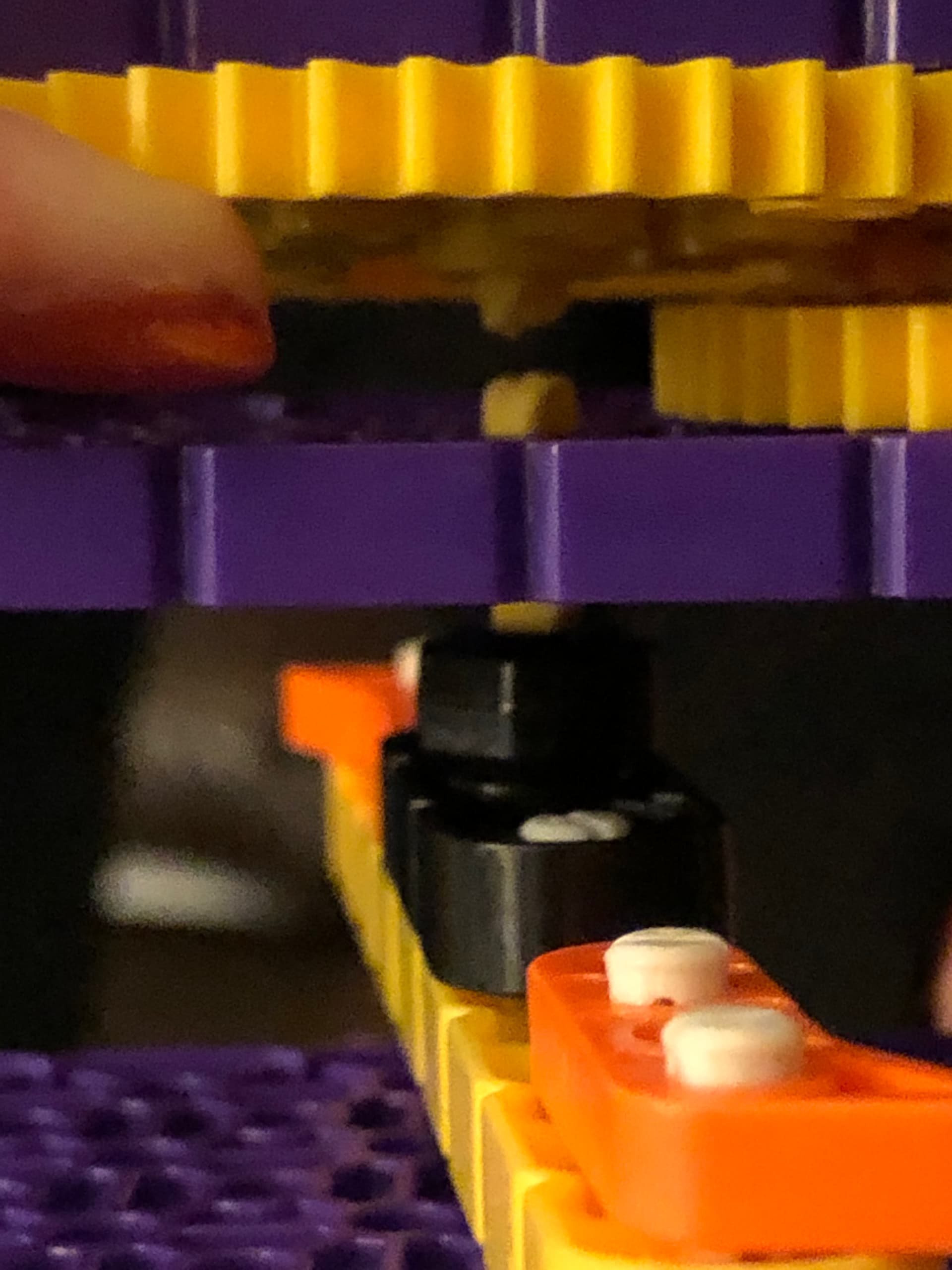

This may have been already covered but I could not find it. Seeing a lot of post regarding the VEX IQ 2022-23 Slapshot purple dispenser yellow shaft breaking and/or twisting. I could not find a replacement part for the yellow shaft. Is Vex offering a pack of these yellow shafts (don’t want to buy $109 field kits to replace 1 intentional break point). Our league has already had 2 break, and we have competitions starting up.
Also - what are other leagues doing to help ensure competitions run smoothly)? Are they purchasing a spare field kit to quickly swap out broken dispensers? Having built several field kits; repairing a dispenser during a meet will not work well.
Thoughts? Options to buy the yellow plastic shaft on the purple dispenser (I think part #228-3449-079 and also the short ratchet shaft #228-3449-078).

This is a bad idea.
Replacing with a metal shaft won’t fix the problem. The plastic shaft is not the problem. The problem is that the arm can’t rotate. If it’s a metal shaft, it will rip out the guts of the gear. The arm still won’t turn, and you might not be aware of the damage that was done. The arm will not preform correctly if the 60 tooth gear has a partially rounded out hole.
This is caused by one of two reasons. One is if the pawl is installed incorrectly on the arm. They made a big deal about that, so it’s probably not the problem.
The problem is most likely the installation of the tower. It’s it’s one hole forward or backward, the arm will fail to cycle. Try it for yourself.
You should see one empty hole between the corner connector and the connection to the tower. This was the source of the failures that we have seen, and now that we are mindful of this we haven’t had any failures.

Our pawls and builds were correct; (verified with instructions and your pic); we have 3 broken yellow shafts; doubt all 3 were spun wrong way. An update from earlier; our head was asked to contact sales. They requested proof of what broke. In all 3 dispensers yellow axle.
Can you reproduce the problem? Was the placement of the top checked in real time? Remember, the plastic shaft is the symptom, not the problem. It is failing because of some other reason in the dispenser.
I have half a dozen dispensers that get dumped dozens of times per day with students. When the arms get stuck, the problem is always the placement of the top. We never have a problem otherwise. Did you try it for yourself?
Have not replicated myself (my goal not to break stuff). I followed the instructions each time and when built I was able to spin freely the right direction and spinning arm dispensed pucks as expected. I did not try high speed; and did not force backwards as the ratchet would stop. Not sure how to insert pic via iPhone (not normal controls and rookie in posting). Rotating yellow arm had no catches (made sure proper holes on orange hooks. Top assembly matches the pics and no sticking spots. Nothing to cause shaft to torque and break (unless someone intentionally spun all 3 reverse and doubt that (coaches and managers with kids at all times snd was stressed to coaches about how fragile purple dispensers were after reading vex forum issues and I believe regional manager warned area directors (?). Does seem from all the forum posts that the purple dispenser was poorly designed when you take into account kids are under a 1 minute timeline to get max points with a fragile piece of equipment prone to break easily. Seems like it would have been better to skip the ratchet lock and eliminate the two posts behind the pucks. If kids spun the wrong way pucks would have fallen out the back and would have not broke the shaft. Hoping Vex will offer a bag of yellow shafts and also ability to buy individual dispenser sets (wouldn’t be surprised if yellow dispensers wear out towards end of season on slide tray.
Spinning the wheel backwards would not twist the shaft that is broken in your picture as it is caught by the pawl. It’s just stopped from moving. Maybe it would damage something else, but it would not damage the yellow shaft in your picture.

  1. Instruct your kids to note if the arm stops rotating when the purple wheel keeps spinning.
  2. Tell them to stop everything and not touch anything at all. The plastic yellow arm can withstand some tension.
  3. Note the position of the basket on the tower.
I will 99% guarantee you that it’s in the wrong place. I do encourage you to try it. Getting it stuck will not damage the tower unless you over rotate it a lot. If I have time I’ll post a video today. If the kids take off the tower before you get there, you will never know if it was misplaced. I check my room from time to time and still find them misplaced from time to time. I’m convinced that trolls come in at night at this point…
And please remember, the yellow shaft is the symptom. Find the problem and let us know what you found! You said this was not the case, what was it in your case? Please share to help us diagnose these problems to help the community at large.
