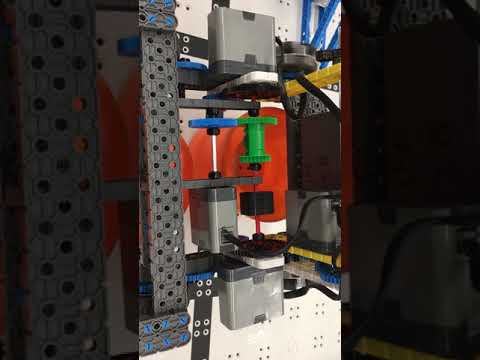

For those that are struggling with not enough power in a 2 motor drive, we just built and tested a 3 motor drive. It works pretty well.
You have to mount the 2 motors facing each other so their shafts are visible. Then put a differential between those shafts, and power it with the 3rd motor.
Then just control the 3rd motor with a forever loop that 1. turns the motor on and 2. sets the speed to (joya/2 + joyd/2).
The extra power allows you to overdrive the final drive for more speed. Also adds a lot of acceleration.
I really like it. What are the red shafts???
Just normal plastic shafts, they are available in colors. The triple stack 2x2 black is where we joined 2 short ones together to get the correct length.
i dont 100% follow this, how do you steer your robot if three motors are going to one axle powering all of the wheels, even with a differential?
The left/right drivetrains are separate, like with the flex bot or most any bot.
The differential is on the MOTOR shafts, not the wheels shafts. I will try to put a video up on youtube in a little while.
You can see 1 wheel, then 2 wheels, then it stops when 1 wheel is forward and the other 1 backwards.

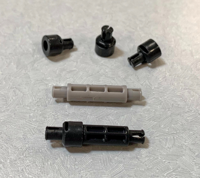

If you are ever looking for a slightly more efficient way to join two shafts together end-to-end, there’s a new VEX IQ part (228-2500-1925) that was created a few years ago for use in the HEXBUG VEX Robotics kits. This part is similar to the 2x2 Lock Plate, but the square hole is offset by one beam thickness (with enough room to fit a Rubber Shaft Collar), and the outside is round.
Currently, the part is only available in limited quantities in a few of these kits, such as
1x here in Orange: HEXBUG Micro Robotic Creatures | HEXBUG
2x here in Light Grey: HEXBUG Micro Robotic Creatures | HEXBUG
3x here in Crimson Red: HEXBUG Micro Robotic Creatures | HEXBUG
And a few other kits, such as the Balancing Boxers and the Mech Loader model in the VEX Explorer kits.
We really like the usefulness of this part, and have been trying to increase our usage of it in new kits where ever possible.
@turbodog The use of the differential to add power is very cool, thanks very much for posting the video it will make it easier to explain to the roboteers how this works.
@Art_Dutra_IV That’s a great part, any chance you can convince manufacturing to put them out as an item. I can see using them as a shaft extender but also a way to get some extra support for gears on shafts.
It’s kind of like what you have when you run an odd wheel drivetrain. You place a wheel in the center line of the robot and that motor runs at half the velocity of the left and right motors combined. both motors going 200 rpm = 400 rpm/2 = 200 rpm. one motor 200 rpm, other motor -200 rpm = 0/2 = 0 and so on.

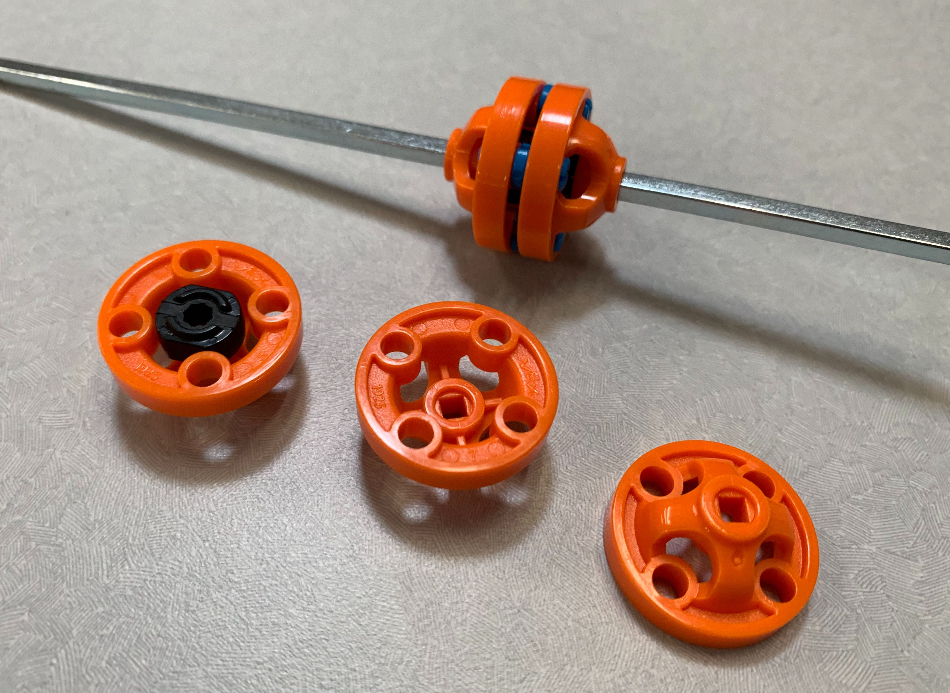

  • 8x of 228-2500-109, the 0.5x Pitch Standoff Extender in Jet Black, shown here:
The 0.5x Pitch Standoff Extenders are great, because you can snap these onto the ends of existing standoffs to make intermediate lengths that currently don’t exist. A great source of these is the Gatling Rapid Fire kit, which contains 27x of these 0.5x Pitch Standoff Extenders in Jet Black.
The Trebuchet kit is the second best current source for these 0.5x Pitch Standoff Extenders, clocking in at 12x in Orange. The Trebuchet Kit also is the currently exclusive source for the 6x Pitch Flywheel (75 gram) weights, which might be useful for counter-balancing some VIQC arm mechanisms.
