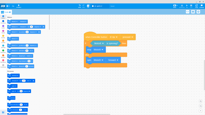

We are using Vex IQ block coding and would like to start and stop a motor with the same button. The simple solution seems like the If/Then/Else command. However, trying that and many other things, the team could never “toggle” back and forth with the motor starting and stopping with the push of the same button. Thanks for any advice we get.

I’m new to the forum other than reading other posts. I hope the image I included works.
What behavior is happening with the code you’ve posted?
When Eup is pressed the motor starts. However, when it is pressed again, the motor doesn’t stop.
“isSpinning” doesn’t actually mean the motor is moving, it means you sent the motor a spinTo or spinFor command and the motor is still spinning to the new position.
You will need to create a new boolean to track the state of the motor and test that instead.

Essentially, what you have to do here is keep track of if the motor is spinning or not yourself. We can do this by making a new boolean in the Variables tab. In my example I named it is_spinning, but you can name it whatever you want.
When the program is started, we want to set is_spinning to false (because the motors are probably not spinning immediately when the program begins).
Then, inside our When Controller button [E Up] [pressed] block, we want to change what the motor is doing depending on the value of the boolean is_spinning. If is_spinning is true, we want to stop the motor and set is_spinning to false. If is_spinning is false, we want to spin the motor and set is_spinning to true.

Something like this should do the trick. (please note that I hardly ever use Vex IQ blocks, but the logic here is correct).
Also a good idea is to add a “wait until <not ((e up button) pressed)>” at the end so it doesn’t cycle over and over, making a random outcome.
