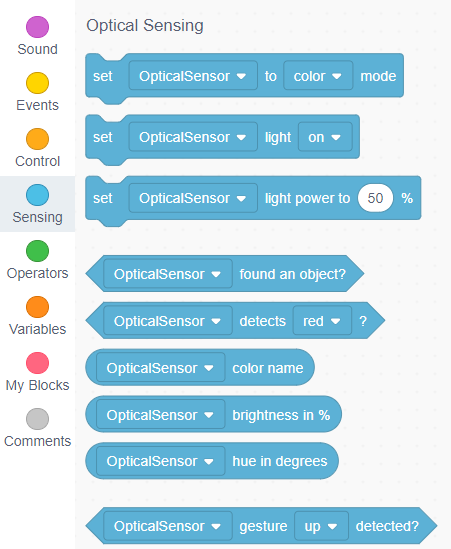

These are the available sensing blocks for the optical sensor:

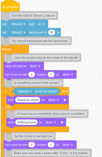

Here’s some quick code I wrote up that prints whether the optical sensor found an object, the color it sees, the hue it sees, and the brightness it sees.
Try experimenting with the brightness you set the sensor to. You may also want to use if hue is between x and y, rather than if color is green, because we don’t really know what the brain counts as green.
In this particular situation, it’s okay to copy that code provided:

No, you have it. I should have been more clear: While there are other blocks relevant to the optical sensor, the blocks I mentioned are the major sensing ones which will be most useful in debugging. The only sensing blocks I didn’t mention were OpticalSensor gesture up detected?, which I left out because I didn’t see it (1st gen thing), and OpticalSensor detects [some color]?, which I ignored because we want an “open-ended question”, so to speak. You could write:
if OpticalSensor detects green?
  print "Detecting green!" to Brain
But you would rather know why it’s not seeing green. Is it seeing red? blue? nothing? We don’t know, so it’s easier to diagnose the problem if we just say, “What do you see?”
The other blocks are, as I mentioned, not sensing blocks; you can tell they do something because of their stacking shape. I’m guessing they’re in the “Sensing” category just because they are relevant to a sensor, but nonetheless, they don’t sense, so I largely ignored them. I did mention, however,

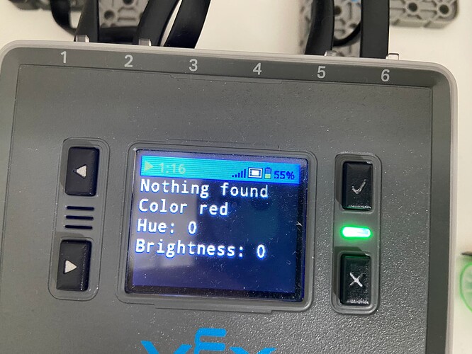

Hi, I am also having problems with the color sensor 2nd Gen.
Thank you for the code to troubleshoot what the sensor detects. I tried the code and this is the result:
It doesn’t matter whether something is in front of it or not. It seems to auto default to red?
I have tried the device info screen on the Brain and it shows accurate color detection, however it doesn’t work with code. We are trying to run the Testbed Challenge for 2nd Generation with multiple sensors.
Any help would be much appreciated.
