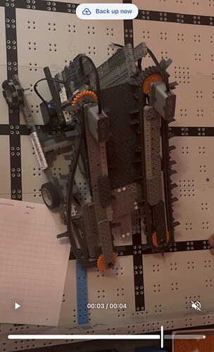

My team is building an intake for the vex iq pins using chain and sprockets. When the pin is going up it keeps breaking the chain and the sprocket.
Are there any suggestions to fix this ?
This is the link to the video -
I have attached a photo here -
i would try using shorter rubber flaps or move the chains further apart.
If the chain is skipping, then i advise making it tighter. If the chain is breaking, then it might be too tight, so add more chain links to make it a bit more slack.
Use shorter flaps and add a beam above the intake so that the pin does not fall out.
One issue with chains/sprockets is that chain tension against the pins in the middle of the sprocket path is less than at the sprockets themselves. We have a few teams in our league who have struggled with this. Strategically-placed standoffs can help with this. A chain tensioner involving a shock absorber is possible too, albeit pretty advanced, at least for an elemtary school team.

This is for mix-and-match? I would’ve thought it was for rapid relay if I didn’t see the title. To fix this, you could add a little bit of slack in the chain, like adding a single chain to the side where the chain keeps snapping. You could also remove a few of the flaps you have on your intake, which are probably the reason the chain keeps breaking off (flaps hitting the sides of the pin, being pushed out, snap).
