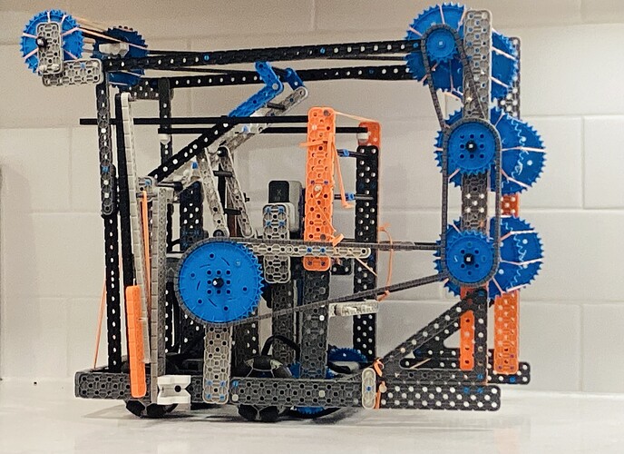

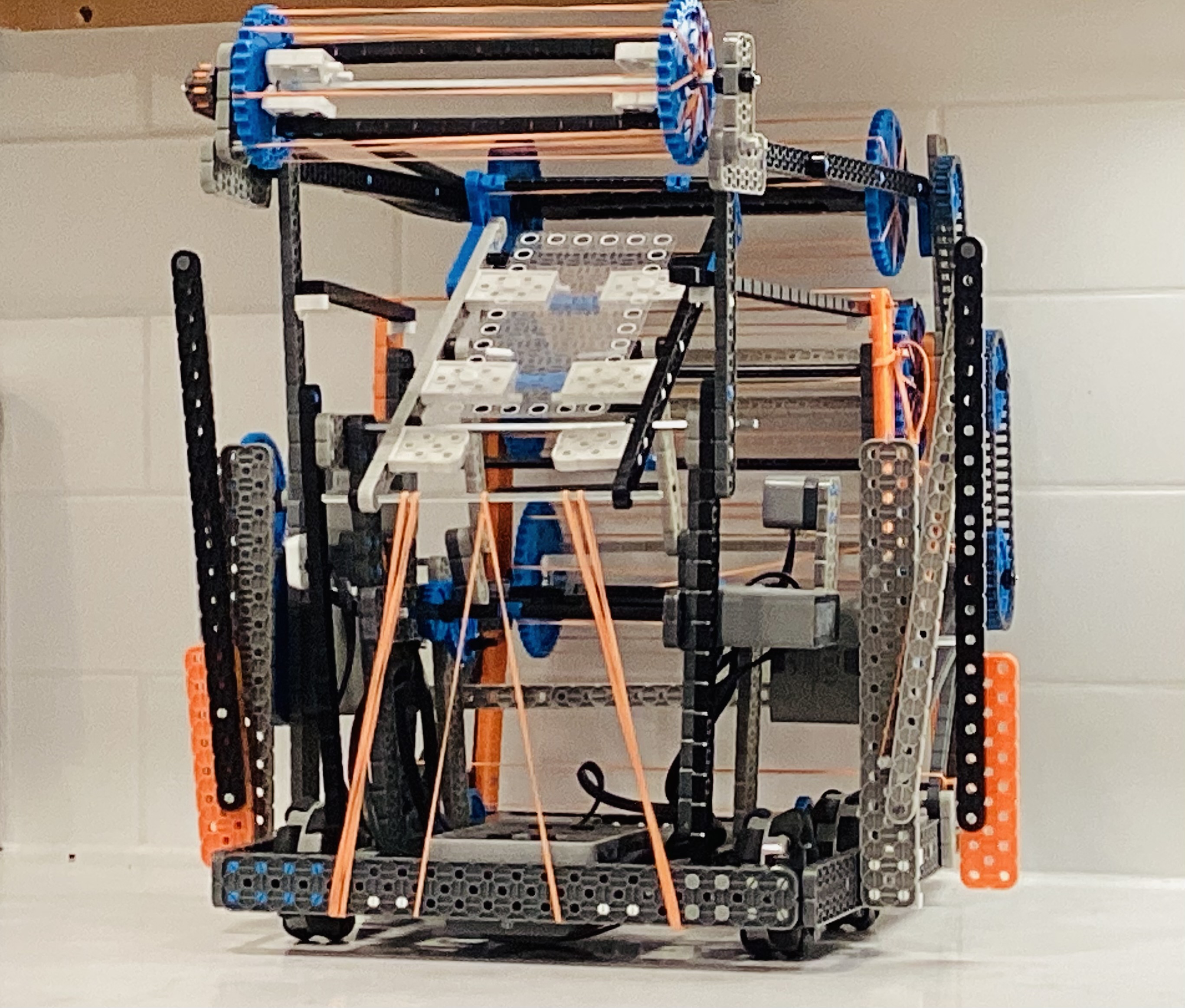

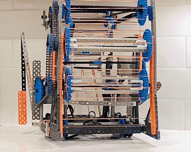

Here is our amazing robot:
This is really good!
I would like to see choo choo mech in action
What’s the drivetrain speed and weight? My drivetrain is 5:2 but the robot is ~11 lbs. not light

My drivetrain has a 48:24(2:1) and 2 motors. our intake is 40:8(5:1) and 3 motors. our choo-choo is 24:36(2:3) and 1 motor. We also use 1 pneumatic air tank, 1 solenoid, 1 air pump, and 2 small pistons.

That’s a fast robot…
yeah all teams should use a gear ratio for their drivetrain, idk why some dont, its easy to build and its efficient
Well, if you gear it the wrong way, then you can be either too slow, and have lots of torque, or be too fast and not go anywhere because there isn’t enough torque. Be mindful and make sure you do it the right way.
But in IQ, changing the gear ratio for the drivetrain is really easy. @76782AHighVoltage’s point still stands

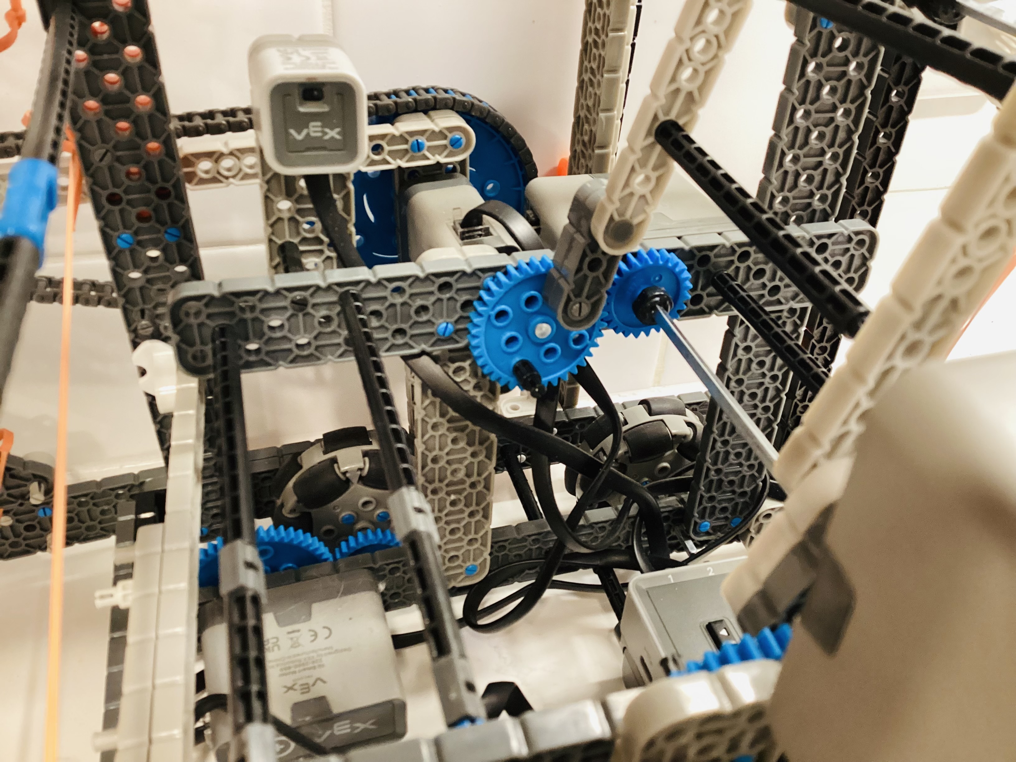

what is a Choo Choo, im in V5RC
It is a series of gears that turn rotary motion to sudden motion, there’s a pic below
IMG_1610
oh I see, last year of over under I sued something called slip gears that has the same effect.
