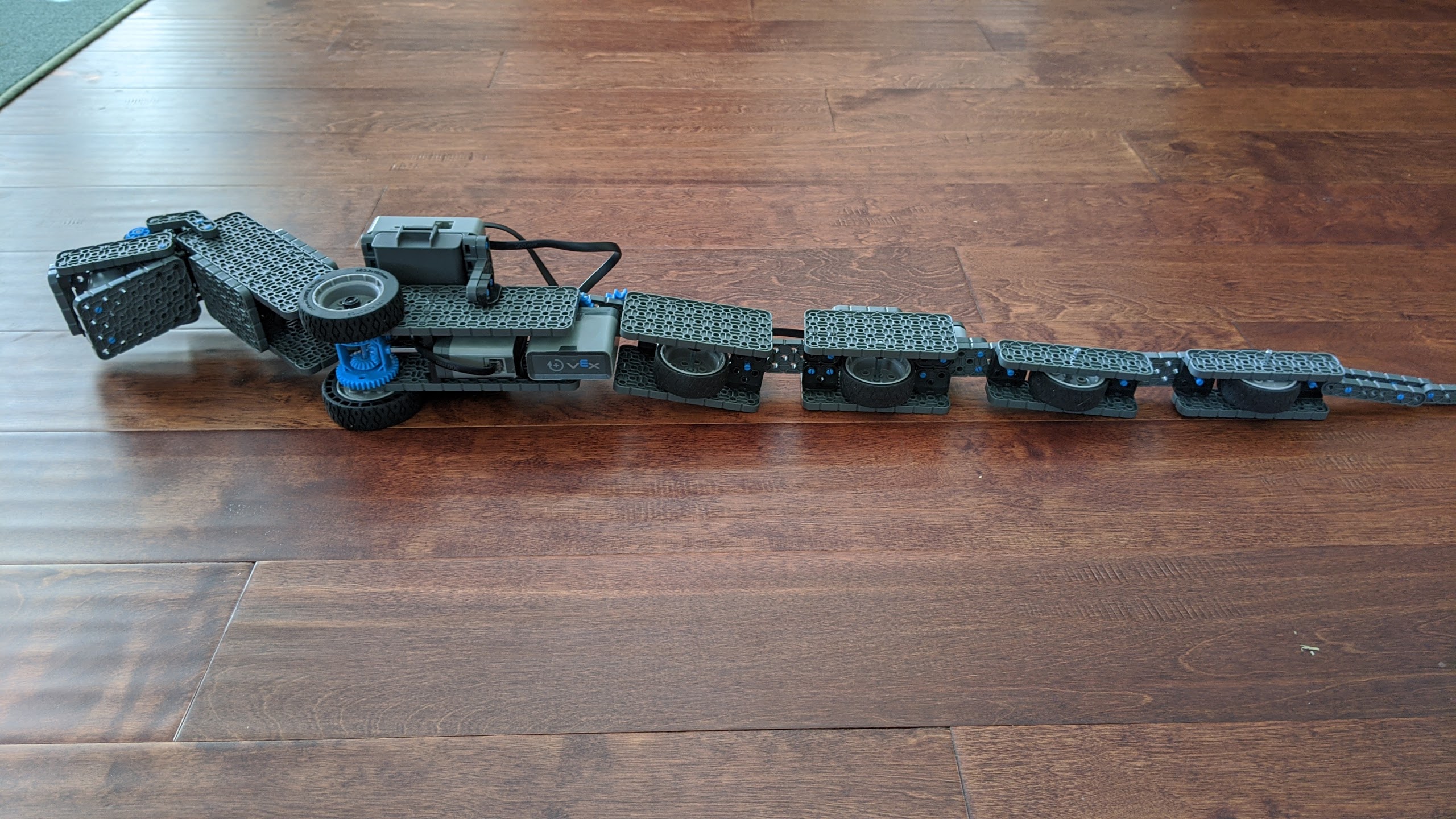

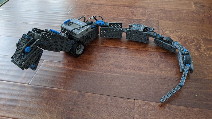

Vex IQ Snake
A fully functional robotic snake that hisses and runs from you when you touch its tail and try to pet it :snake:
This is a video.

I’ve got a video posted! I’m trying to find a way to post instructions but no luck so far.
here’s the code. Not the cleanest but works!

I wasn’t really sure how you drove this until looking at the code and realizing that one motor ran the front differential and the second motor was moving the tail from side to side. That side move makes the head turn and the differential keeps it all even.
