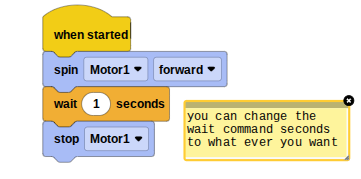

You can either use this block:
imageand change the degrees/ turns value
or something like this
If this didn’t help you then can you please provide a screenshot of your code.
