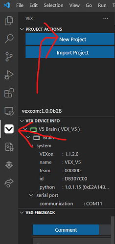

I would not suggest PROS for beginning programming. Instead, I would suggest getting the normal vex extension and using that. After installing the extension, click on the vex icon on the left and select “New Project”.
After that, select V5 and either Python or C++. I would suggest using a Clawbot example project so that you have pre-written code to look at. I don’t know how you do it in Python but the only complicated thing left in C++ is how you define motors. Click on the “src” folder on the left and open the “robot-config.cpp” file, is should look something like this but not exactly since mine is a different project.

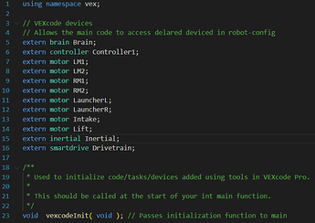

To use this motor in the main code, you need to extern it in the second file called “robot-config.h” In the “Include” folder, It should look like this but with fewer lines since I have more defined.
Inside this file, just type “extern [Device Class Type] [User Given Name];”
Going with the previous example, this is what you would write:
extern motor Grabber;
Once that is done you can now code like normal inside the main.cpp file in the src folder.
