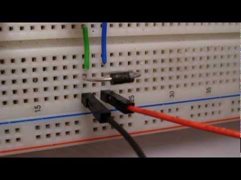

Yep the vex motor is nothing more than a small electric motor that is geared to the output shaft. On the basic the positive and negative wires come out and if you were to connect this to a battery the motor would run. You could also use a transistor to digitally turn it on/off from you vex controller or 4 transistors in an H-Bridge configuration so that you can select direction. Speed control is achieved my pwm from the micro controller into the transistor.
You can see a demonstration of simple on/off and speed control of a motor in my transistor video tutorial. It is for the arduino but will work the exact same for the vex micro controller.
I hope that helps!
