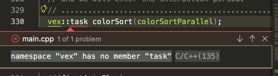

Vex::task is it deprecated?
I’m using the visual studio extension vex v5, but task doesn’t seem to exist in the vex library or the api documentation. Is there supposed to be another way of writing multitask functions?
Use vex::thread
i think its vex::thread now
