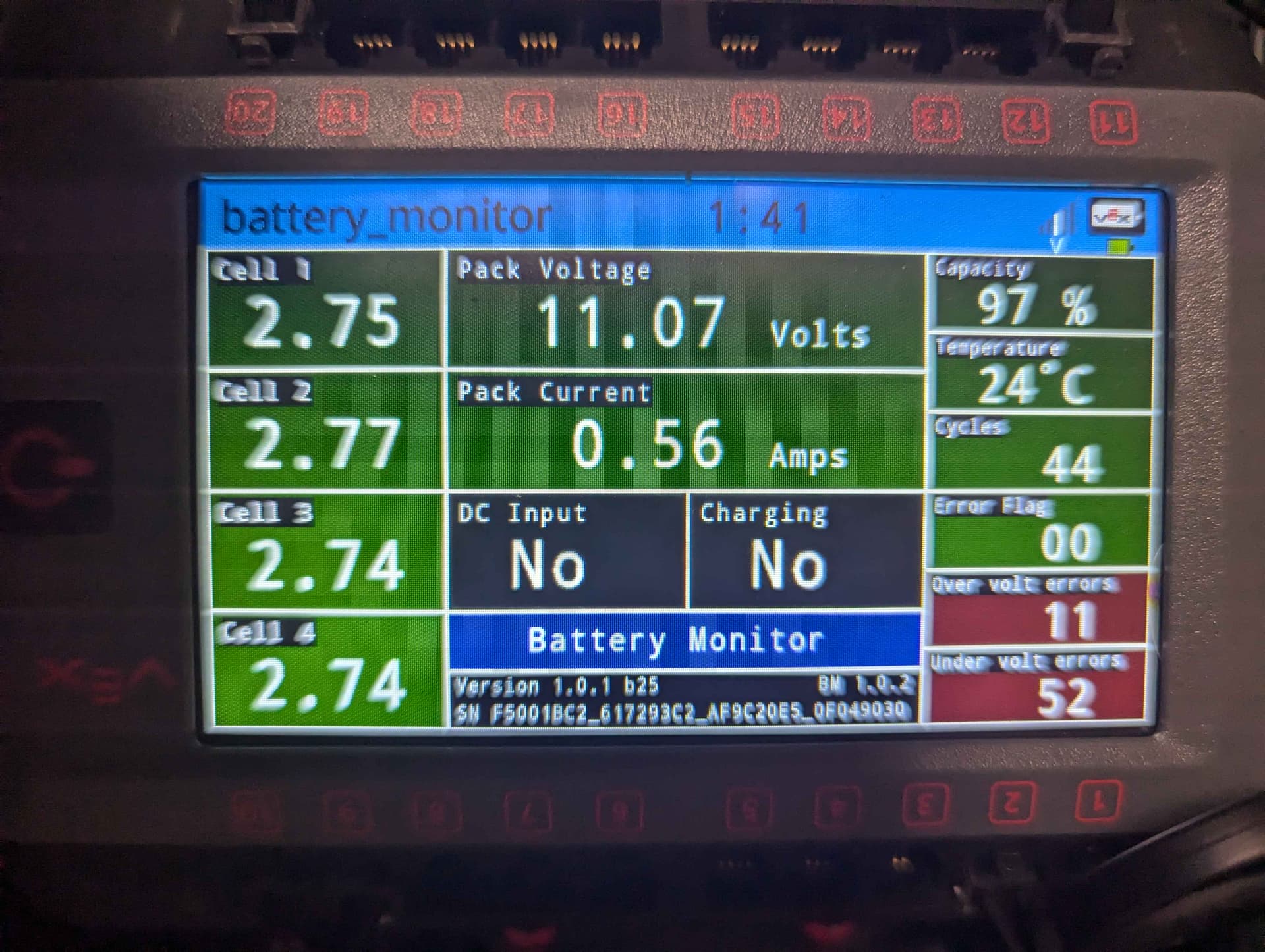

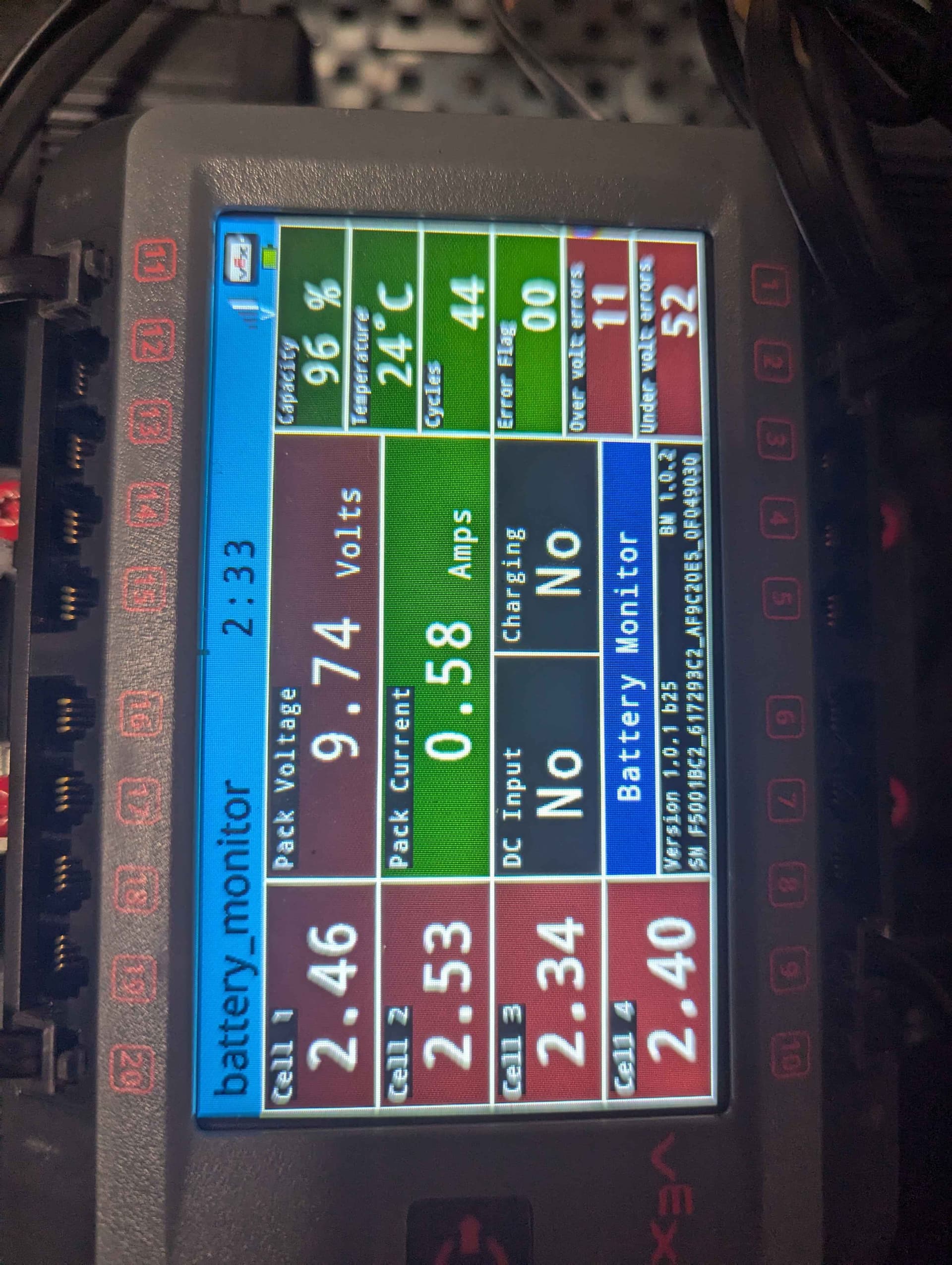

Hi I am having issues with my battery packs having undervoltage errors. They never tend to be able to stay on for more than around 3 minutes before turning off and flashing the LED closest to the button 5 red 5 times per second. I plugged it in to the brain and ran the battery medic program on it and everything seems normal at first except for the high over and under voltage error counts.
After a while, each cell one by one turns red, and then the pack voltage turns red and drops drastically, and then the brain shuts down and the red flashing light on the battery occurs again.
The flashing red light error is occuring on three of our batteries now. Any ideas on how to fix this or are our batteries hosed? Thanks!

Your capacity and pack/ cell voltages are not in sync for some reason. Put that battery on charge for a couple of hours, ignore the capacity and green LEDs. Then run it again on a brain with battery medic running, see how long it lasts before turning off.

It does, but balancing is tricky, we really only know when cells are not balanced near the end of charging. If the battery gets pulled of the charger early then balancing may not finish. The V5 batteries have a different use situation to most other rechargeable batteries we use in daily life, a fast high current discharge often followed by only partial recharging. I guess this situation does happen with hybrid and BEV, but I will admit that our battery firmware is probably nowhere near as sophisticated as the auto manufacturers.

Running battery medic:
All cells 1-4 are 3.25 on the dot (green)
Pack current 1.13 Amps (green)
Pack Voltage 13.05 Volts (green)
Cycles: 143
Could it just be that the battery sustained a large amount of cycles and therefore just contains less capacity than before?

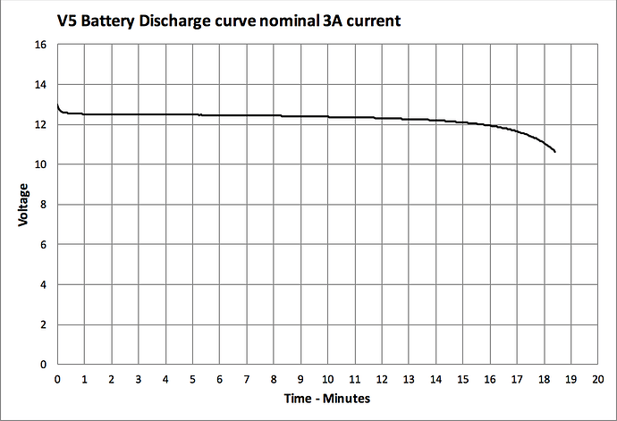

At 1A discharge you should be seeing 45-60 minutes of use.
When we were doing the battery evaluation back in 2018 we would usually discharge at 3A (and also higher) when testing. At 3A a typical battery would run for about 18 minutes.

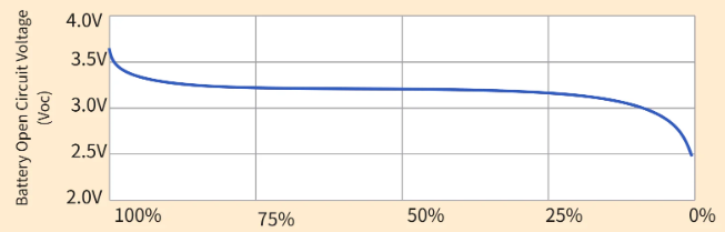

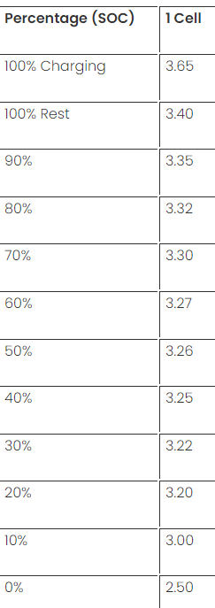

~2.7 volts is LOW, practically dead.
For more SOC (state of charge) voltage data, keep in mind precise SOC from voltage only is not exact. Cell age, temp, etc can affect it.
This is LiFePO4 chart/data

Run battery medic and report back with some screen shots.
