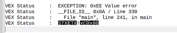

VEX V5 Brain Crash (while using VEX Serial)
Update: I think we were getting ValueError because we were relying too much on Serial Port to give the right commands and not countering for garbage.
I have started to add more checks, like making sure that the input strings are at least same size or longer than the strings we are comparing with. Also if the command arguments recieved with the commands are right type (e.g. angle.isdigit() etc.). Here are examples of the checks I added:
Thank you for the help.

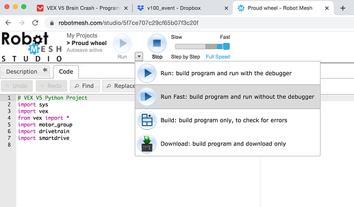

Are you running with the RobotMesh debugger disabled ? It sounds a bit like your messages may be being interpreted by some code in the Python VM.
@RobotMesh
Yes the debugger is disabled. My partner BotWorld, is more experienced with VEX than I am. I help her with mostly Linux usage and Python coding…
How do we enable the debugger?
I don’t use RobotMesh often, but I think you just select different download methods from the dropdown. The debugger uses the same USB serial link you have going to the RasPi.
Did some troubleshooting with Andy8Kahn and BotWorld offline. In case anyone has a similar problem: Exception: 0xEE Value error is thrown when the int() builtin is given a value it can’t parse.
For a contrived example, int('13') will return 13 just fine, but int('thirteen') will blow up. It also cannot handle hex notation when given as a string: int(0x13) correctly returns 19, (probably because the tokenizer is canonicalizing it) but int('0x13') dies with Value error. This is identical behavior to CPython.
