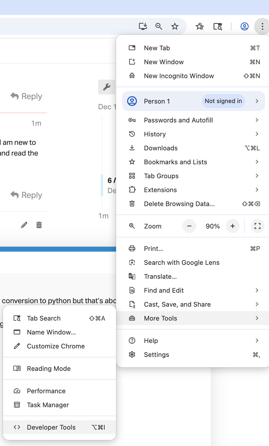

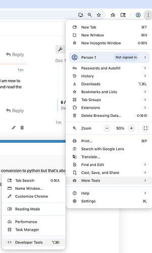

Thanks much, I will try that. Just so I know, how do I access the chrome dev panel? I am new to V5 and a newbie to sophisticated code writing for the brains. ( I can do block code and read the conversion to python but that’s about it).
Make sure VEXcode is closed if using the reset site.
chrome dev tools is under “more tools” menu, it’s a chrome browser thing, nothing to do with our code.
OK I opened the dev panel but honestly I am completely and utterly lost loking at the thing and have zero clue as to where to find (or enter?) the code you posted. I just haven’t the foggiest notion as to what I am even looking at. I see a big panel with lots of stuff I just do. not. understand.

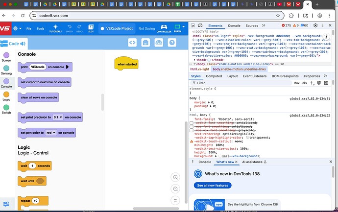

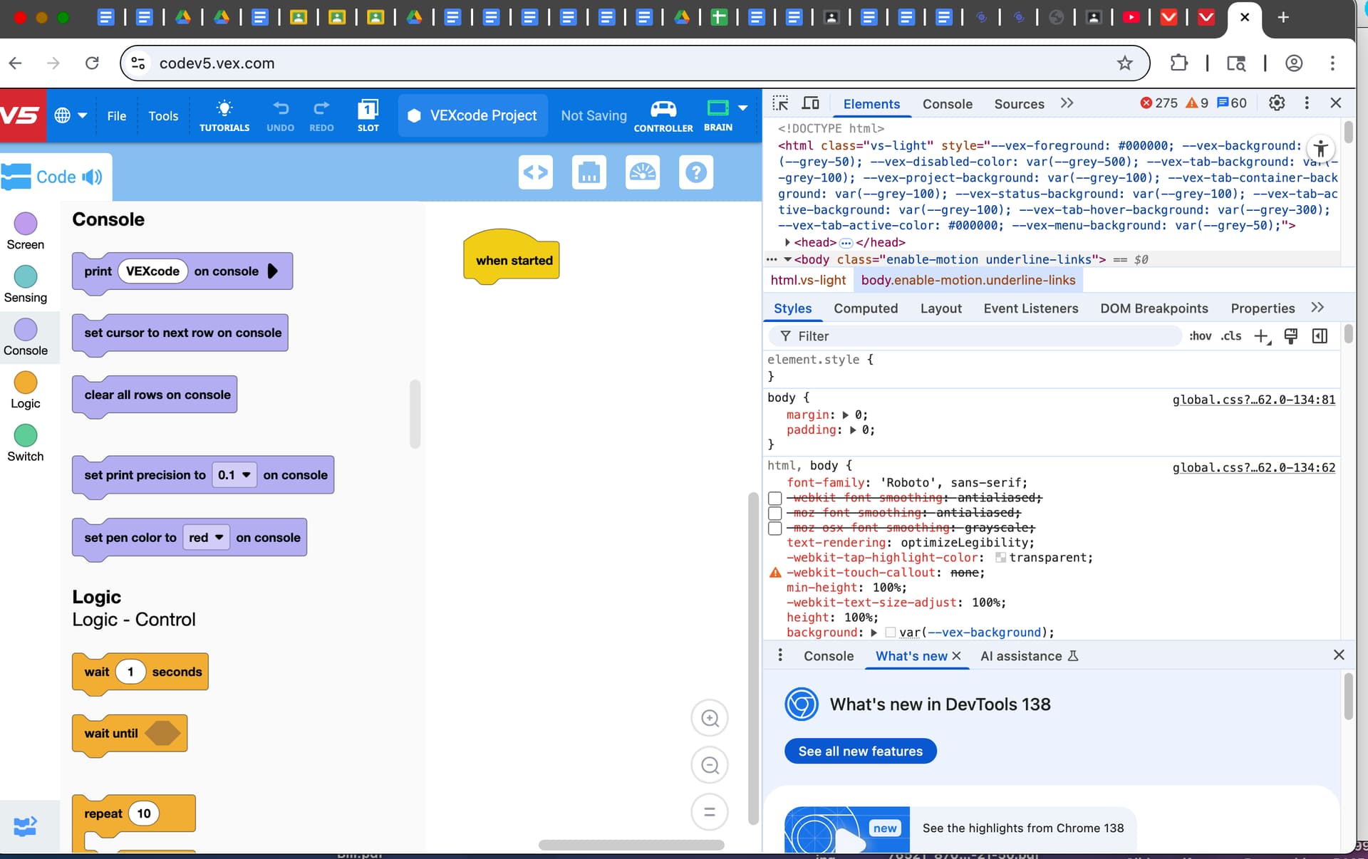

I want to show you what I see when I open dev tools on the vexcode V5 site, with the brain connected and showing green – here it is if I uploaded this correctly
ok, it was probably a bad idea on my part to suggest that.
I had intended you to open dev tools with the reset page active rather than VEXcode active and look at the console to see the messages the reset code was displaying, however, lets not go down that path anymore.
