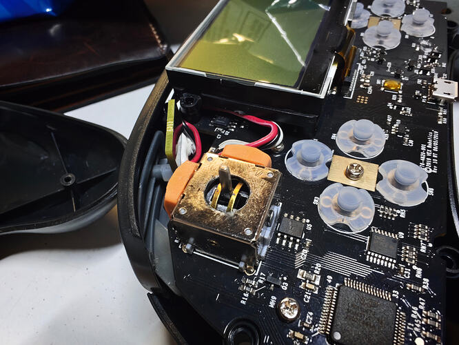

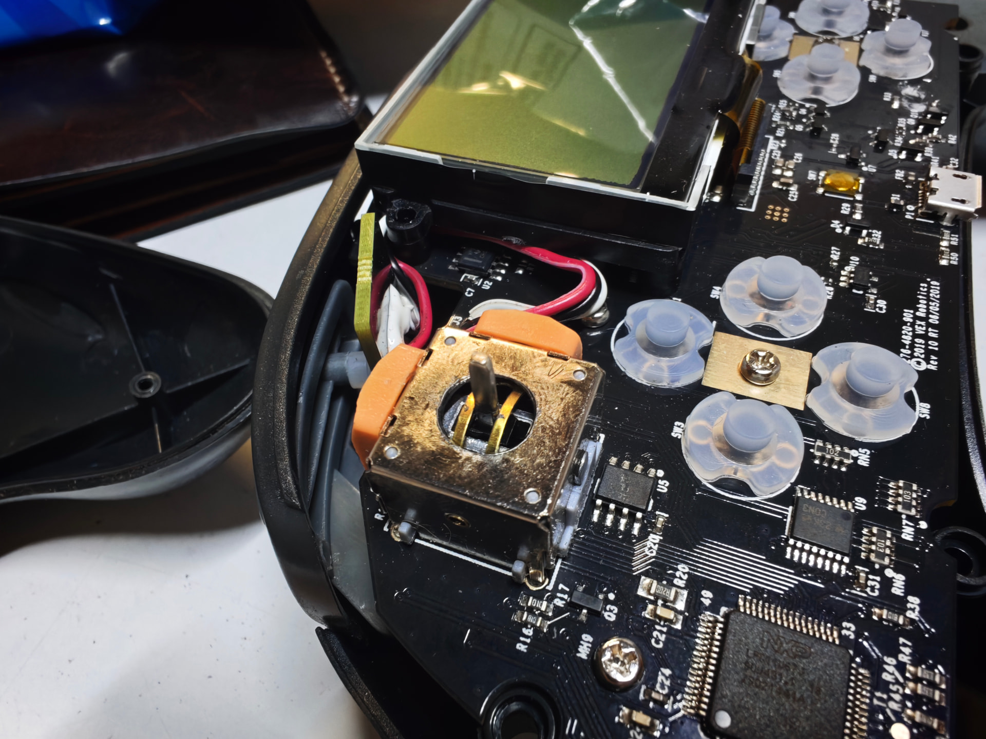

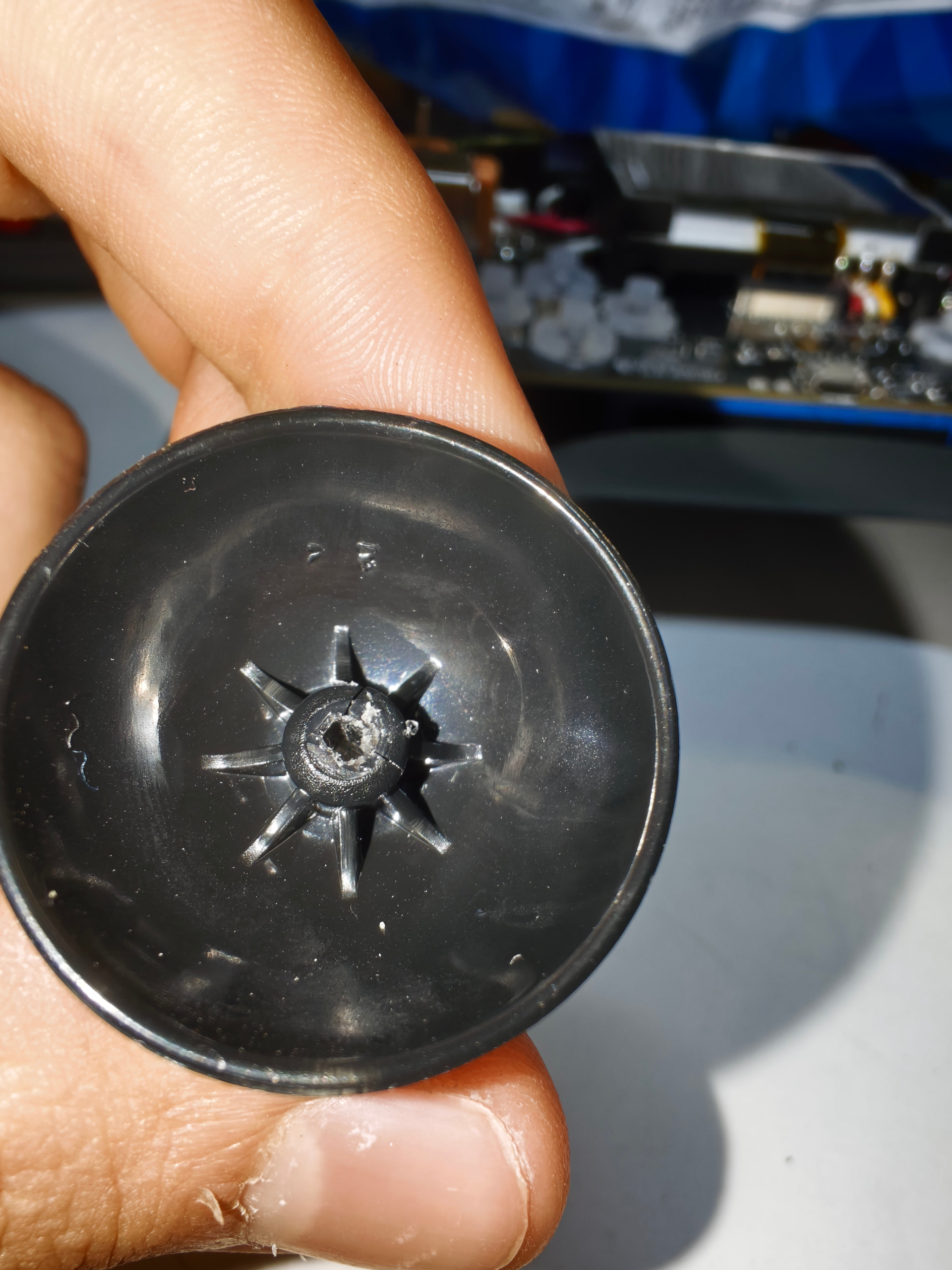

We sent our radio, brain and controller back to the official distributor for VEX here because our radio would randomly disconnect which got replaced. After receiving our gear back we realized that now our controllers left joystick would stick in some random orientation every now and then. We naturally asked the distributor about this but he said that the controller was like that when he received it. (It wasnt) Now we have opened up our controller to see what was going on for ourselves and discovered that the left thumbsticks glue had somehow come off and now the plastic that went in to the metal joystick is damaged and would loosely fit. My question is if we can find a replacement for our thumbstick and where we can it.
I cannibalize other dead controllers, usually the ones with broken MicroUSB ports because I can’t fix those. Joysticks are easy enough to replace, though I wish I could buy identical replacements after-market (the ones I’ve found on Amazon are all for a plastic/nylon shaft and not a metal one like the V5 controller uses).
