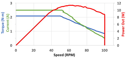

Your best bet would be to use all three motors identically geared around 400-450 RPM simultaneously, since they don’t generate max torque and output power at max speed anyway:
Also, from the thermal load standpoint (to avoid motors overheating) you want to run them at less than 65% max speed most of the time with short bursts up to 100% of nominal speed and power occasionally.
