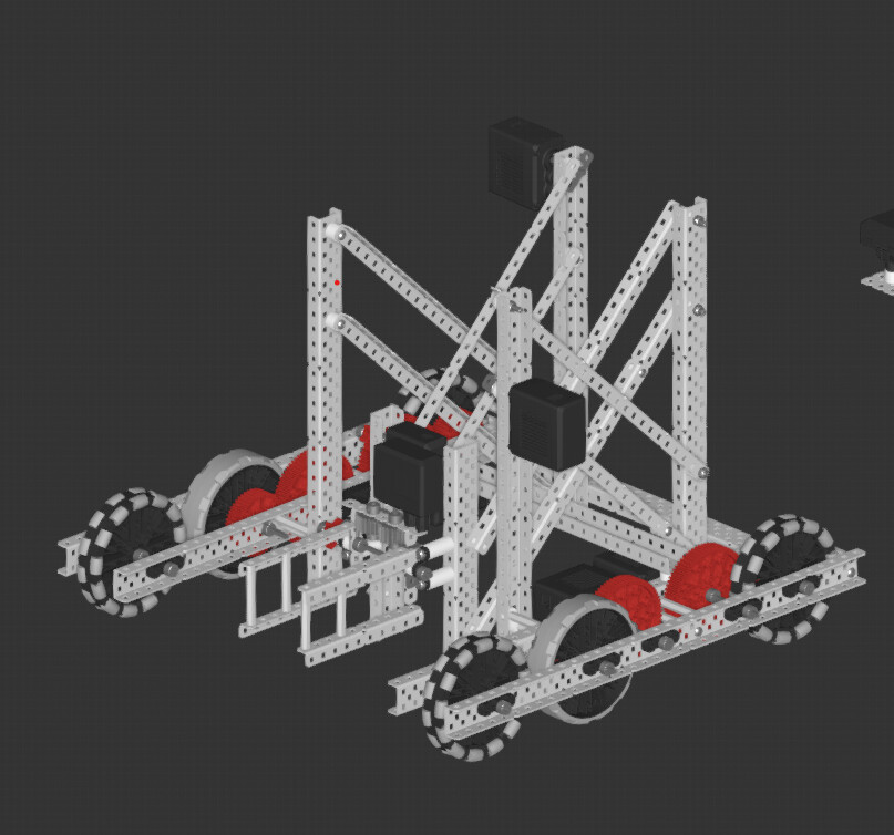

There are so many discussions about this. Im using a dr4b
Here’s my DR4B
I am a little confused with your design, more specifically about the dr4b. I don’t see the gears on it and it looks like each side (the lower and upper) of the lift are individually spun by separate motors. Please tell me if I am wrong but if I am not, I would highly recommend having gears on your lift to make the motors share more load as well as allowing the motors to be attached at symmetrical points.

Thats a 4 bar not a dr4b
That’s a Double reverse 4 bar. A 4 bar only has 1 stage, while a DR4B has 2, as shown in that photo.
Ahh I see it now at first I saw these as braces not the 1st stage.
