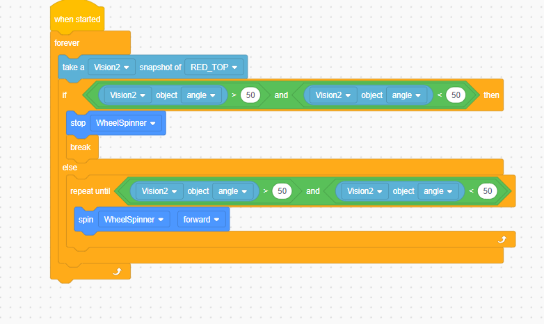

Is it possible to restrict the field of vision sensor?
Say I want the top part of it to look for red and the bottom part of it to look for blue?(Assuming it’s FOV is a 2x3 Grid)

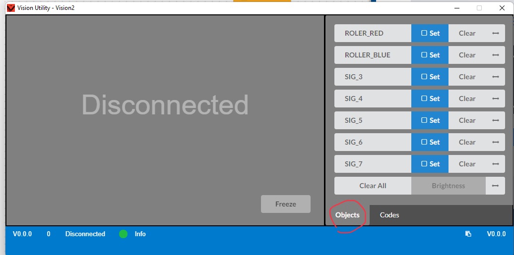

Yes, you can have it see patterns
So your gonna want to configure you sensor first by connecting to the sensor to your computer via micro usb to usb, then you can click the freeze button and set the individual colors.
Then you have to set the patterns like this, you click on the codes tab and
put in the two colors you named previously.
Then the code works by analyzing the frames and seeing the pattern you described to the sensor, and all you have to do is set the angle requirement, which basically is you telling it the red needs to be on top and the blue needs to be on the bottom.
