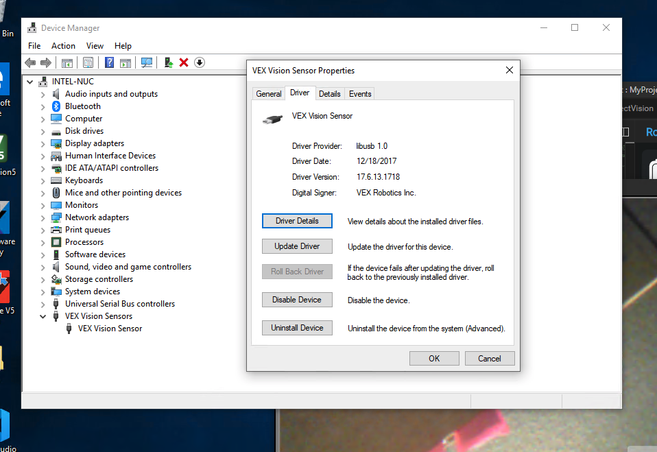

make sure vision sensor is showing up in the device manager.

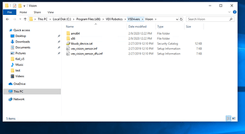

If you want to try reinstalling drivers, they are in the VEX Robotics folder.
The drivers have been fully installed now but it is failing to show up in my device manager, maybe my PC isn’t even recognizing the device
