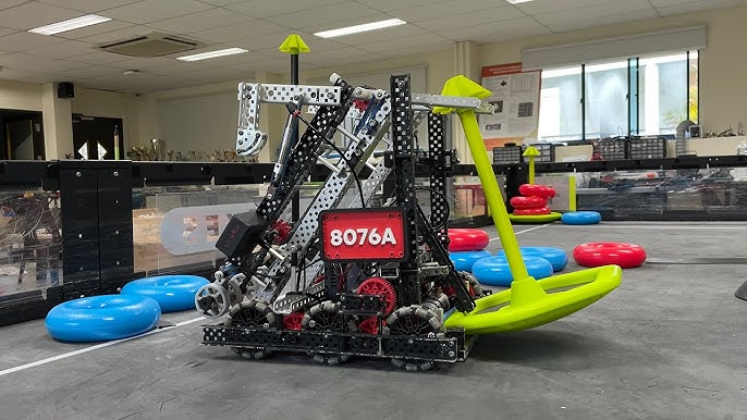

a general rule of thumb when building a drivetrain is,
  1. Have at least 2 full cross braces, meaning they span the full width of the robot, outer c channel to outer c channel
  2. Use screwjoints on the wheels, not only do they not have the benefit of having lower friction than axle joints, when built right they also provide structure to the drivetrain, something even a well built axle shaft drivetrain cant provide
  3. try to stay at a reasonable weight, after a certain point, even well built drivetrains will begin to sag, so make sure your not pushing past 16 pounds, as after that point poor build quality will begin to show itself

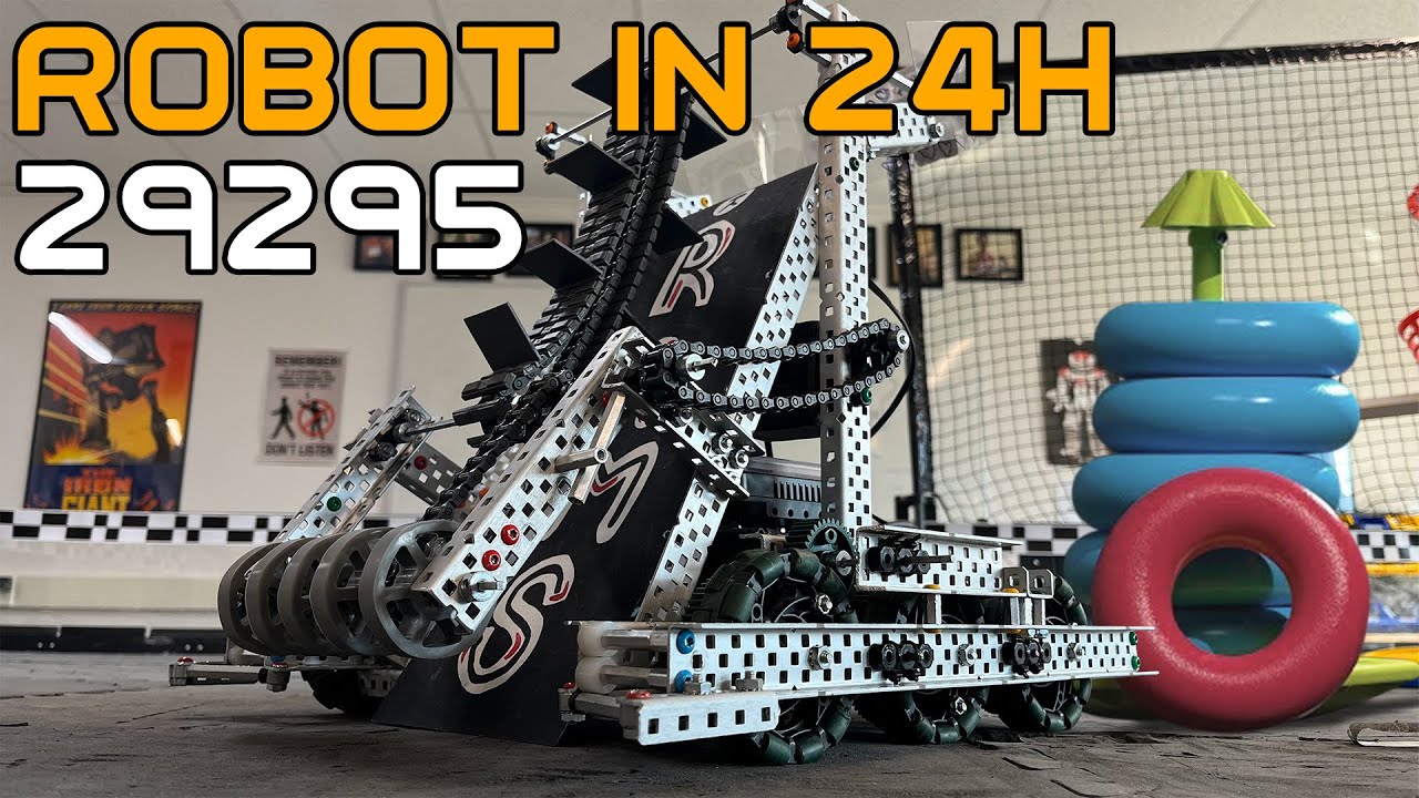

Dude you gotta have a c channel on the outside of the wheels aswell as the inside, its no wonder the robot is flexing, look on youtube or here on the forum on basic examples of quality drivetrains, @Xenon27 has some great examples of quality drivetrains you can look at.
You have to add c channels on the other side of the wheel or it will bend as it only has one point of contact for the axles
Use a c channel on the other side, then attach that c channel to the drivebase
@ryleecooke If you look at all the well built robots a common recurring thing is bracing on both sides of the wheels as well as some form of bracing to keep the two sides of the drivetrain from bowing downward like what happened to your robot

Yeah that could work. I ended up having to add extra bracing to my robot towards the front but it goes up and over the front of my intake. It looks really goofy but if it works it works
Post of the day right there. Thanks for the pictures of all those double support frames.
