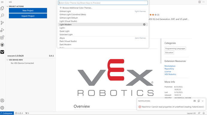

I have been exploring ways for students to use this extension on their Chromebooks. Using GitHub Codespaces I can set up a virtual Visual Studio Code and install extensions, and is free to use for students and classrooms.
Wanted to flag that I still had the “Fatal Error: Cannot read properties of undefined (reading ‘tokenColors’)” when I first installed the extension in the cloud environment using the Dark+ theme that I believe is a default. This is from a blank codespace that has no other themes or extensions installed yet.
I switched to “GitHub Dark Default” and that seems to have loaded the extension now. I don’t know if any other themes work too. It runs and I can create new projects, will have to continue testing to see if it actually can connect and write to the brain within the browser. This will give my students access to git and pair programming while still using their Chromebooks. We don’t have a computer lab anymore to run Windows apps.

    Screenshot 2023-05-05 235842
So I set up a Codespace and installed the VEX Extension version 0.4.1,
I was not able to reproduce the fatal error, but this was an issue for version 0.4.0.
Are there any other steps you took to produce this problem or did it just happen on launch?

This was with version 0.4.1, but the error is only appearing on installation or reload for specific themes. After I install the extension with a compatible theme I can switch to any theme and it still runs, but I do notice that when I refresh the page with a problem theme turned on the error comes back. Something about the initial load of the extension with certain themes is still bad for CodeSpaces.
To reproduce: Start a new Codespace using the “blank” template. Switch to the “Light Modern” theme and refresh the page to make sure the theme is set, then try to install VEX 0.4.1 from the store. I get the error every time with nothing else installed yet and no setting changed from default. Then switch to theme “GitHub Light Default”, refresh the entire page to reload the CodeSpace, and the extension will install correctly.
Other themes that haven’t worked for me are: “Light (Visual Studio)”, “Light+”, “Quiet Light”, “Dark (Visual Studio)”, “Dark Modern”, “Dark+”, “Monokai”.
Workaround: Use certain themes when installing from the store. Working for me are: “Github Light Default” and “Github Dark Default”. Don’t refresh the page while using other themes.
Thanks! I really want them to be able to work on their own devices but still be able to learn the advanced workflows. That’s a shame about USB devices. In that case they could still benefit from GitHub and Live Share of code to write, but then would have to download and upload to VEXcode to put onto a brain, correct?
So I was able to reproduce your issue, this issue is limited to Codespaces only.
For some reason vscode’s default themes extension is not installed on the linux VM, but is still accessible from the editor itself.
Normally when a theme isn’t found, the VEX Extension defaults to either Dark+ or Light+ for VEX Command Help depending on the style of the initially selected theme. But since these themes are a part of the “Default Theme Extension”, the VEX Extension throws an exception because the theme is not found.
So unfortunately you will run into this issue with any theme that comes pre installed in your codespace environment. There is one exception. Any of the GitHub Themes should work fine because it is a store installed extension and does exist on the VM locally.
