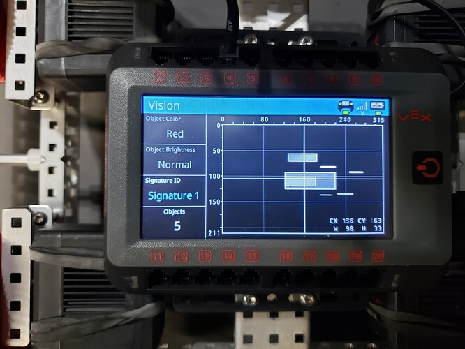

Question: how does the VEX Extension deal with the vision sensor? Namely how to calibrate signatures, colors, white balance etc. Is it possible to use the presets from the brain screen vision sensor test screen? As in instead of looking for a specific signature inside the snapshot just look for objects that are defined as RED in the brain test screen? In the past, no matter how much we fiddled with calibrating and re-calibrating that thing, nothing ever matched the amazing reliability of that test screen to find red blue green or yellow blobs.

So we calibrated, recalibrated, showed that camera every possible red object, turned lights on and off, used the Vision Utility UI and also tweaked numbers randomly and/or seemingly with logical intent, ate some corn, then came back and calibrated and recalibrated some more. The bestest outcome we could come up with is this. This image does not even do it justice as everything bounces around like fireworks and number of objects and their coordinates are all over the place.

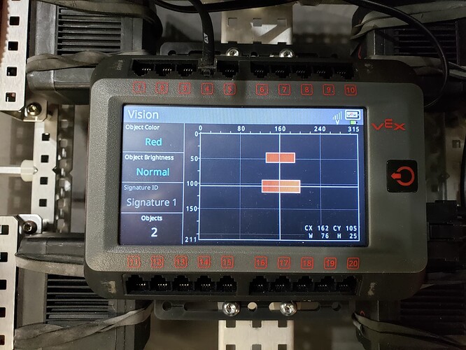

Then we kill the code, restart the brain and go to the dashboard. No more calibrated signatures carefully crafted to our environment, lighting and redness, just boring old defaults programmed in by James. This thing not only perfectly outlines the 2 sections of the red goal but it does not move, just sits there +/- 2 pixels mocking us with its perfection.
There is only one explanation. James uses alien technology and/or dark magic.

Halen reminded me that there had been a request for the signatures that vexos uses to detect objects in the dashboard. They are nothing special and were created using the same tools you have, they are.
vex::vision::signature RED_BALL    = vex::vision::signature (1,  9127, 10643,  9884,  -607,     1,  -302, 6.9, 0);
vex::vision::signature BLUE_CUBE   = vex::vision::signature (2, -3615, -2849, -3232,  7837,  9429,  8634, 3.7, 0);
vex::vision::signature GREEN_CUBE  = vex::vision::signature (3, -6371, -5205, -5788, -3855, -2855, -3354, 3.0, 0);
vex::vision::signature YELLOW_CONE = vex::vision::signature (4,  2159,  3375,  2766, -4481, -4079, -4280, 7.4, 0);
