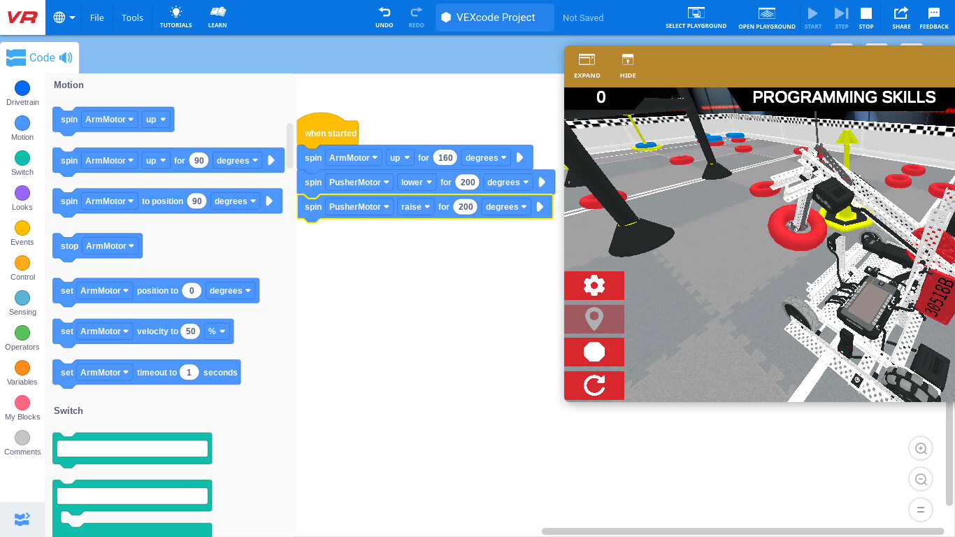

Hi so I’m trying to code the VR challenge for my team and I can’t figure out why my code is not letting the ring go, are any of you able to help me?
In my experience on Vexcode VR, you need to set it to lower and raise for 2 turns. The program also has its fair share of glitches (No hate to the people who made it), so that could also be something.
The Pusher Motor moves the pusher down the Arm. This allows for rings to be pushed off of the Arm and onto a stake. The Pusher’s position at the top of the Arm is 0 degrees.
To push a ring off the Arm, the Pusher Motor must lower for 780 degrees.
