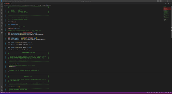

I know the extension is relatively new and still has some things to be worked out, but i began writing a code for our team and the code is giving me errors before any actual code is written, other than the motor setup.

It looks like the VEX Extension is not installed on your version of Visual Studio Code.

You have installed the PROS extension, not the official VEX extension. Uninstall the PROS extension and then install the official VEX extension and you should be good.

So a couple of things
  • It looks like you have clangd installed, your going to need to uninstall this.
  • Did you install the c++ intellesense extension?
    • Check out this very end ot the installation guide below or download and install from here: C/C++
  • Did you import this project? It looks like it was created in VEXcode Pro V5.
    • Only imported VEXcode Pro V5 projects will be recognized by the VEX extension.
