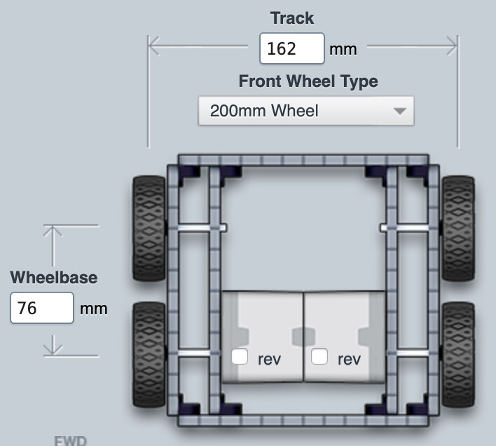

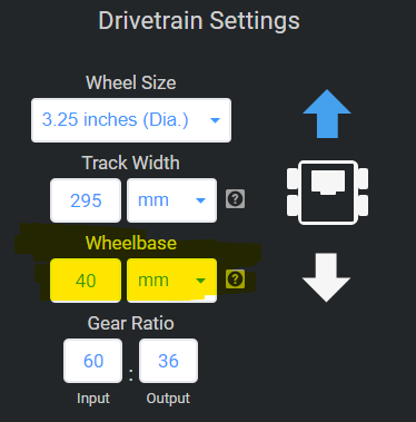

no im talking about this
this should answer it then. take you ruler and get to measuring. wheel base and trackwidth have no relation to the middle wheels only the farthest outside ones.
Not always, depends on how the wheels are driven and what type they are. See this and earlier posts in this topic.
Ohhh okay, thank you that clears it up.
