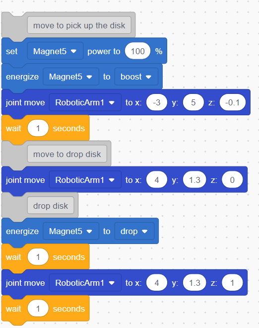

Has anyone else had problems with the disk pick up/drop off in Labs 7/8? Our workcell is all over the place. We originally used manual move to get the coordinates, but realized that was highly inconsistent. So we used Arm Jogging to get the coordinates and that worked better but still every time the program is run, the arm goes to a different point than it did previously and it isn’t always the same point it will be one place one time and a completely different place the next. Not far off a centimeter or two, but always off. Any help would be appreciated. I am getting very frustrated and losing class time because we can’t get it to do what it is supposed to do.

With the disk pick up/drop off, I would suggest adding in the code a block that sets the electromagnet’s power to 100%, adding in a wait statement after the drop code then raising the arm in the z direction followed by another wait statement. Also, the electromagnet should have a plastic sticker on it while the disks shouldn’t. If they both have the plastic sticker on them, there might be issues with disk pick up/drop off. I have attached a picture showing an example of the coding for picking up and dropping the disks.
