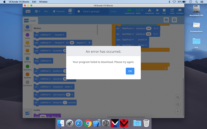

VexCode Block - File Download Error
I get an error when trying to down the program to the V5 brain. We are running Mac OS 10.14.15. All firmware updates have been done. The error message says, “An error has occurred. Your program failed to download. Please try again.”

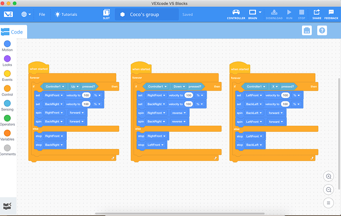

Thanks for the reply. There are no other apps open. This program download to the brain the first few times we tried testing code. Then this errors came up. Here is a screenshot of all the code in the file.
Try putting all the if statements under a single when started statement.
Yeah, this probably wouldn’t cause it to not compile but that code probably doesn’t do what you want it to do. If, for example, you press and hold down only the up button on the controller, then there is one piece of code constantly telling motor RightFront to spin at 100%, and another piece of code constantly telling RightFront to stop, which is not really a useful combination of commands.
To continue tracking down your original problem, I don’t immediately notice anything in your code that should cause it to not compile (but I could have missed something). If the failure to download did not coincide with any changes to your code, then the problem likely lies elsewhere.

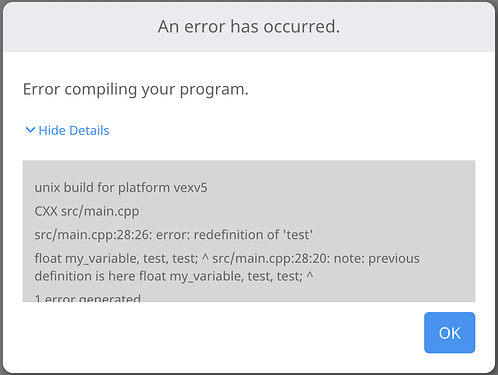

The new update (coming today, actually) will resolve a lot of these issues.
Most of the time the issue is related to a compiler/code problem where the software allowed you to do something you shouldn’t have. Something as simple as a variable declared twice with the same name will generate that cryptic error message. Here’s what the NEW message will show if the duplicate variable issue exists:
OK, that definitely sounds like it’s a compilation error in your code - could you post the .v5blocks file in this thread? (or feel free to PM it to me if you’d rather not post it publicly)

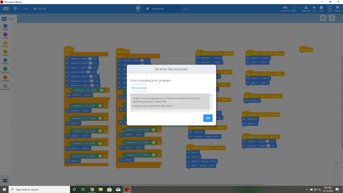

im receiving the same type of error but it says
make’ is not recognized as an internal or external command,
operable program or batch file.
make process closed with exit code : 1
If you restart the application does it resolve the error? We found a bug in the latest version that if you do many downloads in a single session (30+), the Path variable runs out of space. This issue has been resolved in the next update.
If restarting does not resolve the error, then it may be a permissions issue for the “Temp” environment variable that the compiler (make) uses - basically “make” doesn’t have access to generate all of the temporary files needed to compiler the program to send to the robot. Is this a school managed machine? Has it worked in the past?
