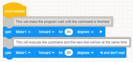

So, today my school has been attempting to learn vexCode Blocks. We figured out the driver control section, but I’m not sure how to have multiple motors running at the same time. Can somebody help me figure this out? Your help will be greatly appreciated.
In auto, you will use the “and don’t wait” option.
@sankeydd beat me to it, but I’ll post my pic as well.
blocks
The first part shows running 2 motors with a wait, then stopping them. The second part is lilke sankeydd’s example of blocking and non-blocking code.

In theory we could have as many motors as we want running at the same time right?
I have a four motor drive and just want to ensure the full drive will run.
Yes, any number of motors at once.
