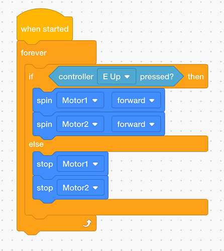

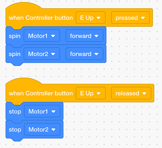

is there a way to put multiple motors on one button in Vexcode blocks
Sure, here are two example programs that do just that:
