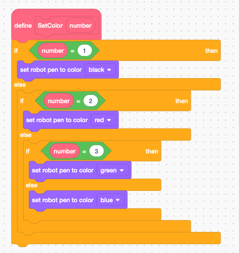

Hello!
I was looking at lists and variables for this, but both seem to only accept numbers, not text.
Is there any way to change the robot pen color in a loop, like first t me through the loop then pen color is red, the next time through the loop pen color is blue, then green… etc…??
Thanks!
Jess
You could define a function like this that maps numbers to colors:
Screen Shot 2020-09-24 at 10.48.03 AM
Then call SetColor in a loop, passing different numbers to it.
Oh wow!!! Wish I would have thought of that!!! :O) Thanks so much for the quick response!!! :grin::+1::+1::heart:
