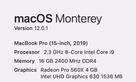

Could you give me a bit more info about the machine you are running on? Like is it an Intel machine or M1? Everything I’d want to know would be in the overview tab in the About This Mac window.
Another thing you can try, is installing VEXcode V5 Blocks and seeing if you have the same issue. They are similar enough applications that if one runs then they both should. So seeing if that runs can help narrow down any issues.
Hello @tbobik, I have an intel MacBook pro from 2019. Screen Shot 2021-11-10 at 3.46.20 PM
