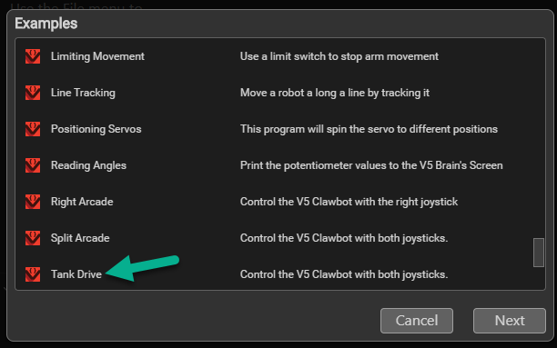

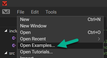

For teams that are starting out from scratch, they can start with the included examples like:
Then open the Tank Drive or Arcade examples:

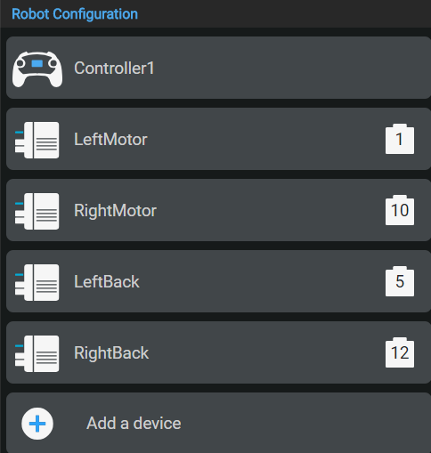

Then adjust the Robot Configuration to include the two additional drive motors:
