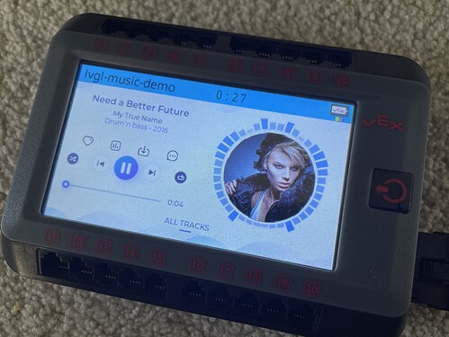

The LittleV Graphics Library (LVGL) has some nice demo code. One example is a music player demo, it needs the latest version of LVGL. I was updating the VEXcode LVGL library repo today to the latest (7.11.0) and thought it might be fun to try the music player on the V5. Works quite nicely.
source the for project is here.
and if you want to change LVGL configuration, the vexcode lvgl library project is here.

No, it’s just the most recent demo that LVGL seems to use everywhere.
Just wanted to show, again, that VEXcode V5 Pro can easily use LVGL to create a more advanced UI.
