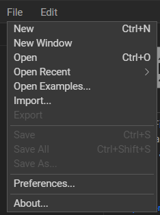

I switched from VCS to VEXcode, even though they are both C++ based, the program won’t work in VEXcode. How do I add motors? How to I add driver control?
Please import a VCS project using File-Import
For more info please refer to the knowledge base at
There is no file or import on my computer
And theres no robot configuration on mine either
@tfriez is the import feature a 1.0 thing?

The import feature is not specific to 1.0
(Downloaded Two Weeks Ago)
It seems to work now, no more errors thanks so much
