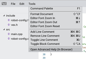

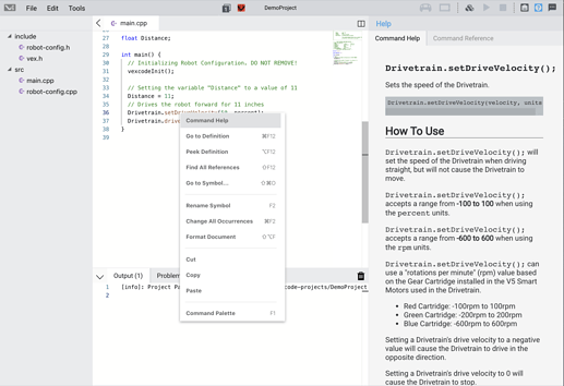

Command Help is available for the simplified SDK commands initially by right clicking on a command (method). We’ll be adding more to the built-in help as we continue to update over the coming months.
In addition, you can look at the full SDK documentation in the Advanced Help from the Tools menu:

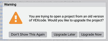

Are we required to use VEXCode 1.0? I have been using 0.9 just fine, but now I am unable to download code from that version. I really don’t want to be bothered using the graphical robot configuration or uncommenting 500+ lines of code per project, and would like to continue using the previous version of VEXCode
Not Upgrading Projects
You can choose not to upgrade your 0.9 projects to keep the “expert autocomplete” active and not use the built-in Robot Configuration tool. Choose “Don’t Show This Again” to keep the “0.9” style projects.

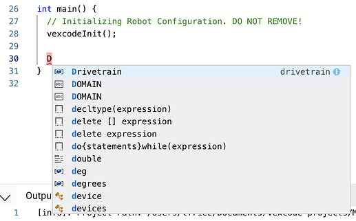

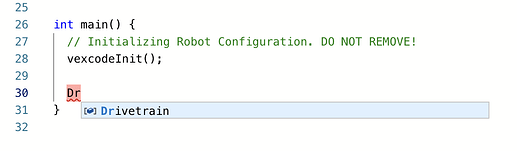

Enable Expert Autocomplete
VEXcode V5 Text 1.0 does not require you to use the simplified autocomplete - you can enable “Expert Autocomplete” via the project setting.
Simple Autocomplete Example:
Enable Expert Autocomplete:
41%20PM
Expert Autocomplete Example:

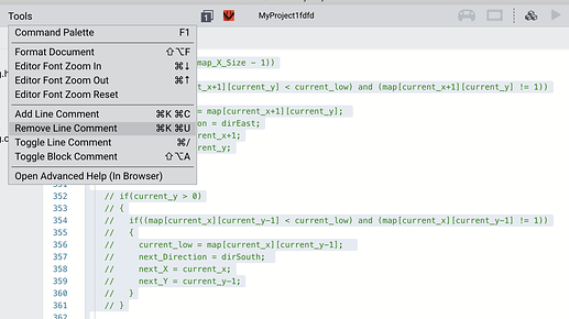

Uncommenting Lines
If you have upgraded your project to 1.0 and you want to “uncomment” a large block of code, highlight the commented section of code and select “Remove Line Comment”.

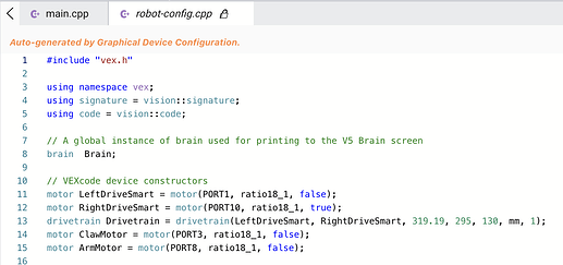

There are some great improvements with this update… but
doesn’t ring true, as the robot-config files are read only. You would need to make an additional include and then glare angrily at the empty files that are sitting in your list.
A disable auto-config button in the device setup interface would be a nice add for the next pass.
I don’t disagree, however
you nearly always need an instance of vex::brain. That’s the only thing that’s always defined in robot-config.cpp, then just avoid using the Robot Config panel, define motors and other devices in main.cpp or other files as needed, just ignore the auto generated config files exist. They can be deleted, but would be created again if you add a device in robot config.
