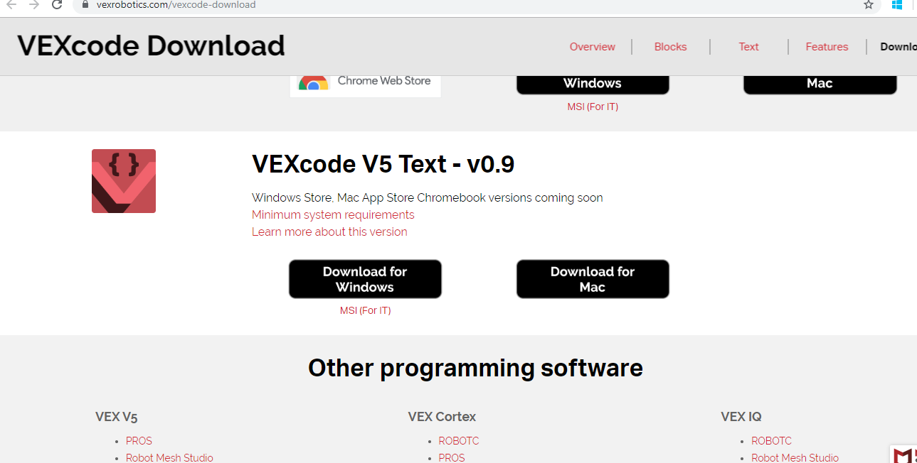

Just curious on the link it still says that it is version 0.9.
Is that an error and we’ll get 1.0 when we download?
says 1.0 for me
and more character
Website update might lag a little behind… the links are pointing to 1.0.
Ok yeah it just updated for me. Thanks!

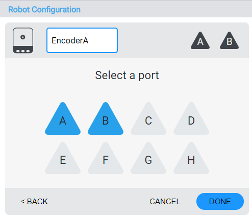

In the Robot Configuration, under Quad-Encoder, you cannot select B and C.
aa
Edit: someone told me that the processor inside the brain cannot handle a Quad-Encoder plugged into ports B and C

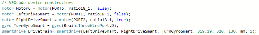

The drive train varaible is missing a space before the equals. This only happens when you add a 3-wire gyro to the drive train. Also this doesn’t cause any errors, but someone is sure to be annoyed.

Correct, B /C is an illegal combination and cannot be selected.
This applies to both the quad encoder and sonar, the three wire port firmware is not flexible enough to allow all possible combinations of ports for these sensors, it’s restricted to A/B, C/D, E/F and G/H
