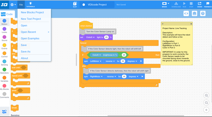

There is line tracking code in the examples under File → Open Examples. I tried it and it works well.
