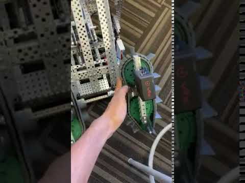

So, I did some quick testing. I ran this on both of my robot’s rollers with voltage control and then velocity control. On voltage control when I held the roller and stopped the motor from being able to move it at all, the motor reported MAXIMUM (but usually around 1.5A when I held it) of 2A. When I held it with velocity control running, the motor took 2.5A instantly. Both times were tested with 12000mV voltage control and 200rpm velocity control, and note that I did test velocity control after voltage control so the motor isn’t stalled (there is no temperature level warning on the brain either). When I printed measured voltage, I got close to 12000 with voltage control and around 10000 with velocity control. Here are videos:
Velocity control:
Voltage control:

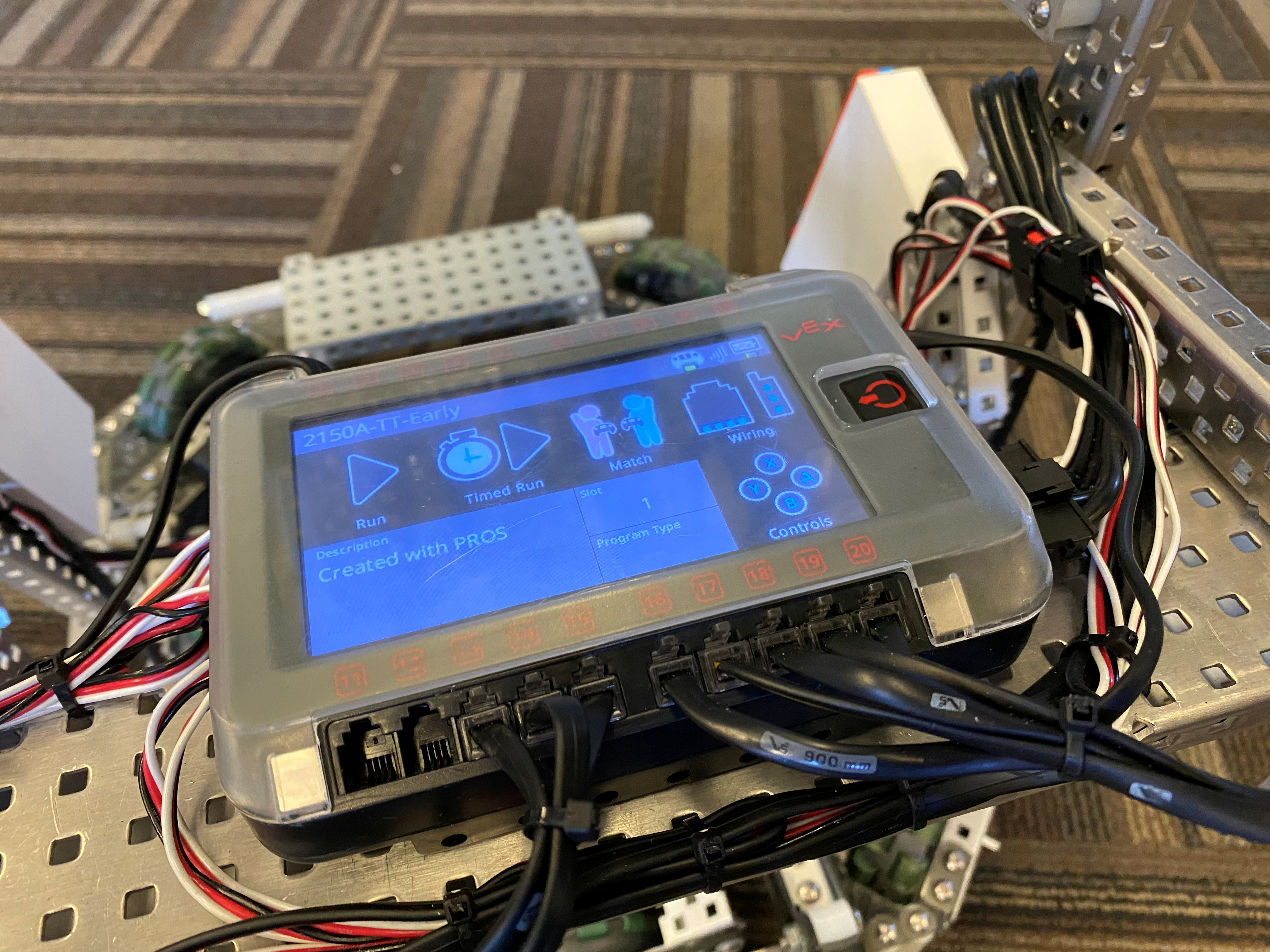

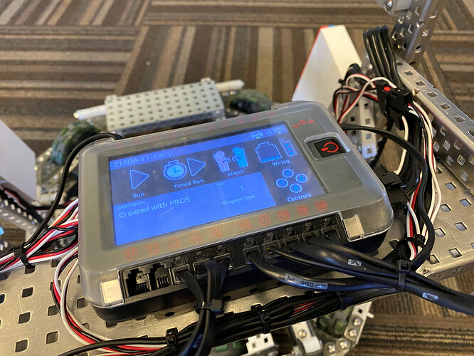

It’s quite the stark difference in current. Here is what my brain setup looks like:
I have 8 motors, 1 IMU, and 1 radio plugged in.

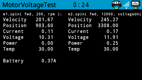

Well, I retested and find no issues.
the code I used was this.
      if( c.ButtonA.pressing() ) {
          m1.spin( fwd, 200, rpm );
          m2.spin( fwd, 12000, voltageUnits::mV );
        else {
          m1.stop();
          m2.stop();
with no load on the two motors I see these numbers.
motor_noload
The motor under pid control is running at around 10V, the voltage control motor is at almost 12V.
