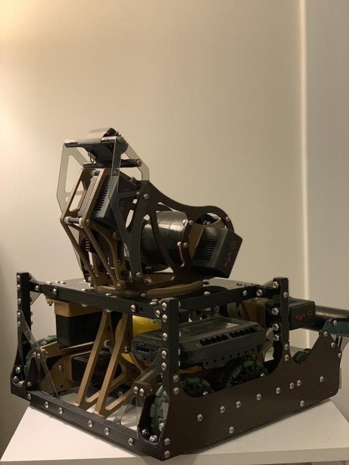

Hello everyone,
It’s been a while since I’ve been active on here… and since I’ve competed… But during the pandemic I became interested in computer vision and got the chance to back the Luxinos kickstarter for the Oak-1 camera. I quickly realized the potential usefulness for this device because of its small size and all computations are done on board so there is no need for large GPU’s like a Jetson. Unlike the current Vex Vision sensor, which is just a reskinned pixy, these cameras run at high resolutions and framerates. They also let you train your own custom models which give the flexibility for them to work in different environments. All these features are the basis of a more robust vision system that could be more comparable to something you would see in FRC.
Last summer I began playing around with getting these cameras to communicate with the V5 brain by using a Raspberry Pi to communicate through the micro USB port on the brain. Some of you might have seen those demo’s but here they are:
At the beginning of this year I decided to start a project to actually implement this onto something that would be more applicable to VRC and be a fun experiment for applying custom fabrication, physics, and programming into a presentable project. I decided to make a flywheel turret robot that would shoot the Turning Point plastic 3" balls into a goal around 5’ high from anywhere on the field, taking a lot of inspiration from the FRC game Infinite Recharge.
I designed and built this on and off during the semester and now that school is ended I got a chance to program and test it to a point that I am happy to share with everyone.
Unfortunately right now the code is not in a state where I want to release it publicly, and until that is done I won’t be working on any documentation on how the control system works for tracking the targets and how to communicate from the camera to the brain, but I WILL eventually be making all that public, I was just too excited to share this to wait until all of that is done.
I’m happy to answer any questions anyone has about it in the meantime, and I hope this possibly inspires some VexU teams to pursue using higher level vision targeting in future games :slight_smile:

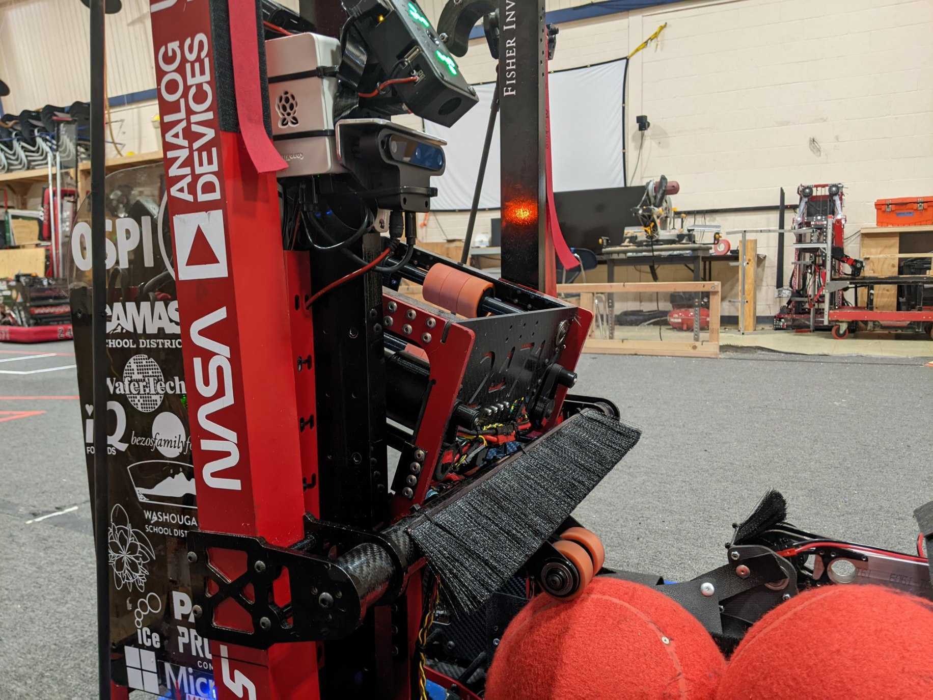

Hello @Zach_929U,
Thanks again for sharing this on our Discord! And since you mentioned FRC, OAK-D has already been used there as well! See video here and the image below. Since we are trying to focus on robotic vision - are there any suggestions you could provide to improve our platform (depthai), or any painpoints you have experienced during the development of this awesome robot?
Thanks again, Erik (Luxonis)
Thanks for reaching out Erik,
The process was pretty smooth to get everything working. If you’re looking for suggestions to widen the user base though, an easier process for getting annoted datasets into trained models that can be deployed might be useful (I’m sure you are already working on this or it already exists and I just couldn’t find it).
From what I was able to find online the easiest ways for someone to go about this would be with the Roboflow Collab notebooks put out a couple years ago or use the built in roboflow train (you only get 3 credits though). I’m sure you can share some better resources you know of though.

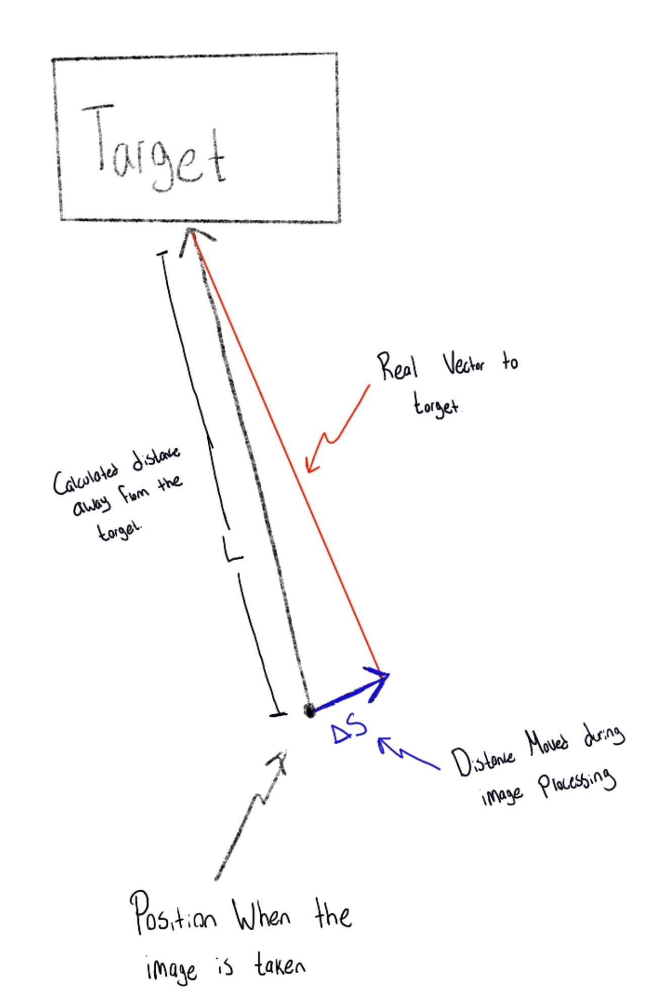

The first important thing to understand is how to calculate the distance from the target to the robot from the image. Because in this situation the height of the target is known and constant, you are able to use the pinhole model of a camera to simplify it down to simple right angle trigonometry using the resolution and FOV of the camera.
Latency compensation becomes important to use because as you can imaging the robot has moved between the time the image was taken and the time that the image was processed. So, the calculated position of the target using the method above does not reflect the state of the robot in the real world. (picture below)
Using this, what I do is take a new reference frame of the robots position every time a frame is captured by the camera, while that image is processing it will update the position of the robot in that reference frame, then when it is finally calculated you can use triangle math (law of sines/law of cosine) to create a third vector from the robots current position to the target which is what you should be aiming at right now.
Hopefully that makes some sense.
On top of this though, it is easy to imagine how you account for lost frames as well. If the object is not detected in the image when it is done being processed, you can use the calculated vector to the goal from a previous frame as a replacement to the actual camera reading. In essence, all this does is make the distance “Delta S” from the above image a longer value.
This creates a robust control system because the odometry is being used as a backbone to the camera, and the camera is used to reduce distance that odometry has to be accurate for in order to know exactly where the target is.

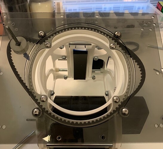

This is really interesting to me. I haven’t taken Dynamics in awhile, but Is the gyroscopic torque directly opposing the turrets rotation, or is the gyroscopic torque + the weight causing extra friction / binding in the turret mechanism?
Correct, the gyroscopic force of the flywheel is opposing the rotational force from turret, intuitively you can think of the turret rotating like trying to push down on the edge of a spinning top. In a game like Spin up this would be way less of a problem since the wheels are sideways though.
It does not create binding because it is has decent tolerances and it’s all on ball bearings, but it does create resistance to motion for sure. pics below:

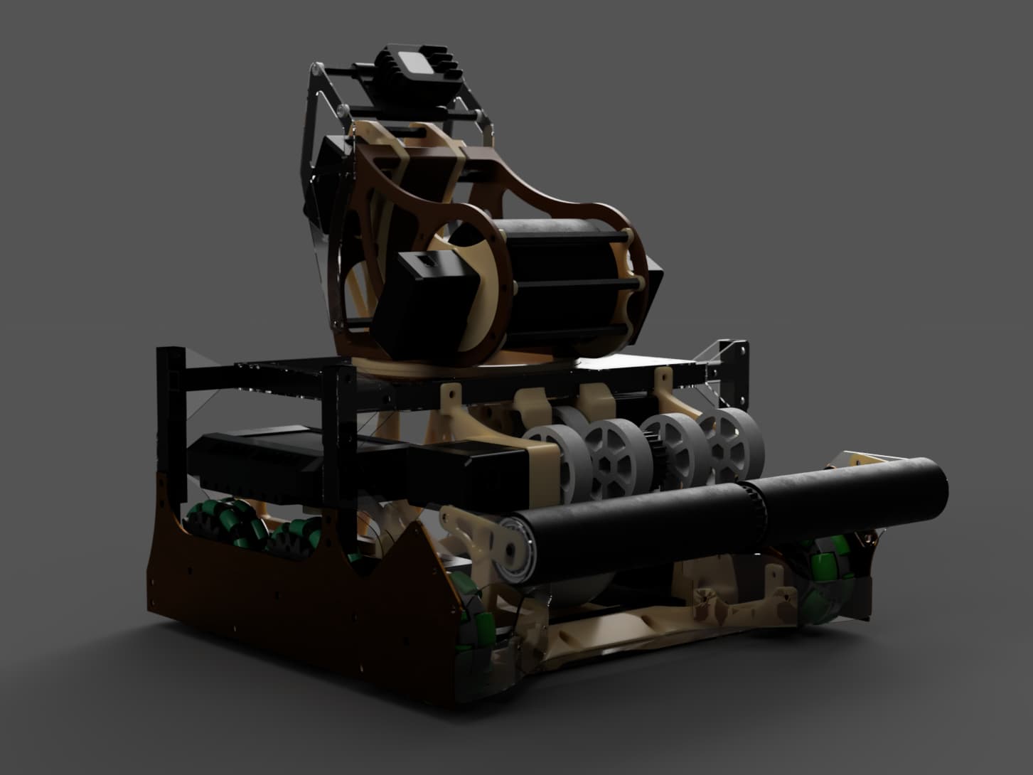

Sorry to bump this thread again, Here are some renders of the CAD model that I thought I would share though!
As always, let me know if you have any questions!

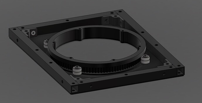

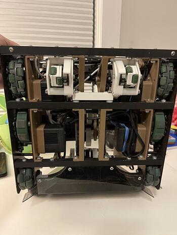

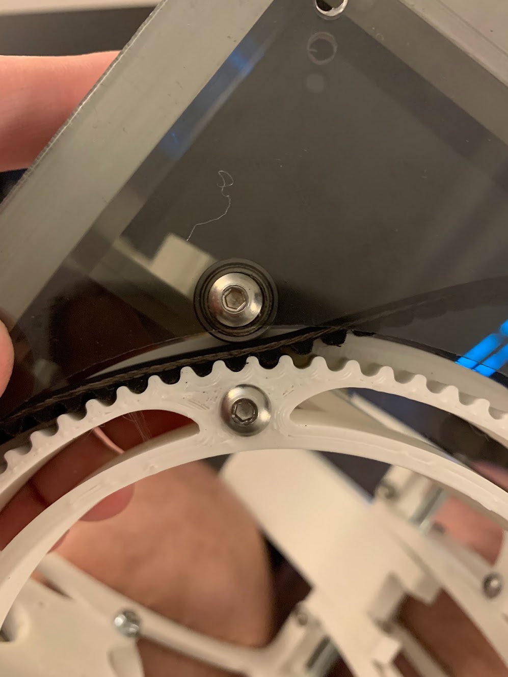

@Nfoster Sorry for the delay on this, school has been killing me the last 2 weeks. This is gonna be a pretty long post too because I have a lot to explain to help you out! Lets start with the CAD model, it can be found here (CAD MODEL). Because this is exported as as a step, it unfortunately lost the transparent polycarbonate textures and are now set to the default gray color.
Anyways, lets go through how it was actually built. The most helpful thing I can provide is a google photos link that documents most of the build process, which can be found here (GOOGLE PHOTOS).
Now, lets go from the bottom up on how this thing was actually made:
  • The drive train is made of 8 wheels total, 2 of the old 3.25" omni wheels, 2 of the old 3.25" traction wheels, and 2 of the old 2.75" wheels drilled out to spin freely on 6-32 screws. The last 2 wheels are custom printed 40mm omni wheels that use the 3.25" vex omni wheel rollers.
  • The outer and inner drive rails cut from a 1/16th inch aluminum sheet on a CNC mill.
  • The Drive is cross supported using 0.5"x0.5" aluminum square tubing with 1/16th" wall thickness, which is plenty strong for this small scale stuff.

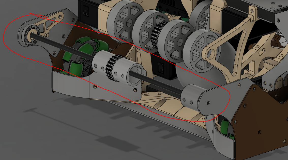

  • All the gussets that support the vertical tubes that hold the entire turret assembly up are milled from 1/16th polycarbonate, every other part on the robot that isn’t a standoff is 3D printed using PLA+.
  • The powered drive wheels are riding on 0.25" diameter ‘Deadshafts’ (which are just standoffs) with bearings on the wheel and gear for low friction.

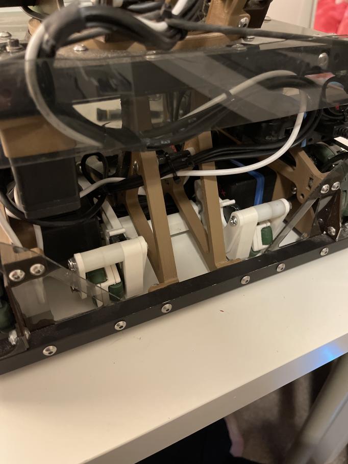

  • The front roller is probably the most confusing assembly, i’ll try my best to explain it with images and videos:
    Because I wanted to use the FRC style latex tube over pipe trick for the intake, but also was using hard plastic balls to shoot, I decided that I needed to make some form of compliance on that front roller. To do this, I thought of a clever trick to hide a linkage inside the middle of the tube.
    There is a thin aluminum pipe inside of the wider roller that I thread and screwed into the polycarbonate structures on the outside, then a small 3D printed part with a pivot point and slot to ride on the inner pipe to connect to 2 bearings. Those bearings then connect to the pipe via another 3D printed hub not in the image to allow it to free spin, but also pivot up and down. If that made no sense, here’s a really old video when I was explaining it to other competitors so don’t mind how unprofessional it is haha.
    https://www.youtube.com/shorts/RmYg03zpfTk

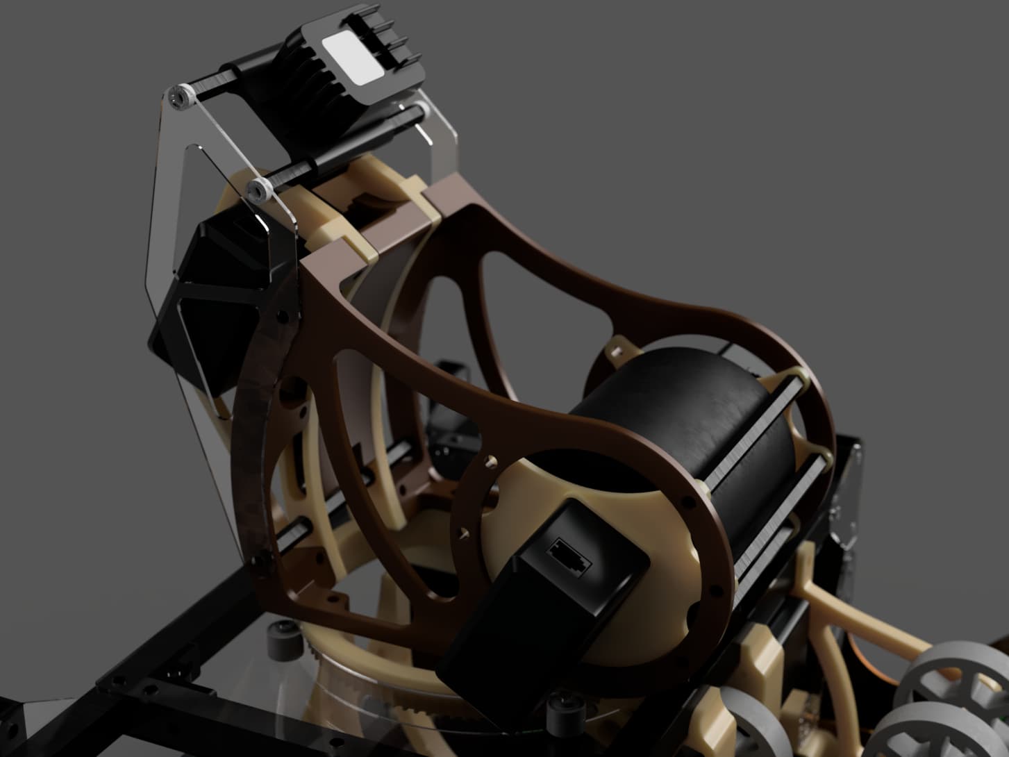

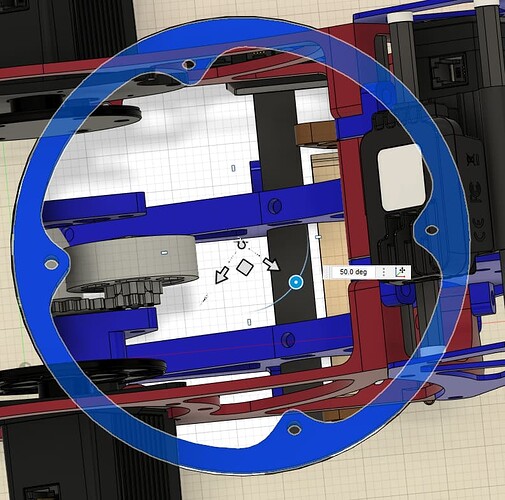

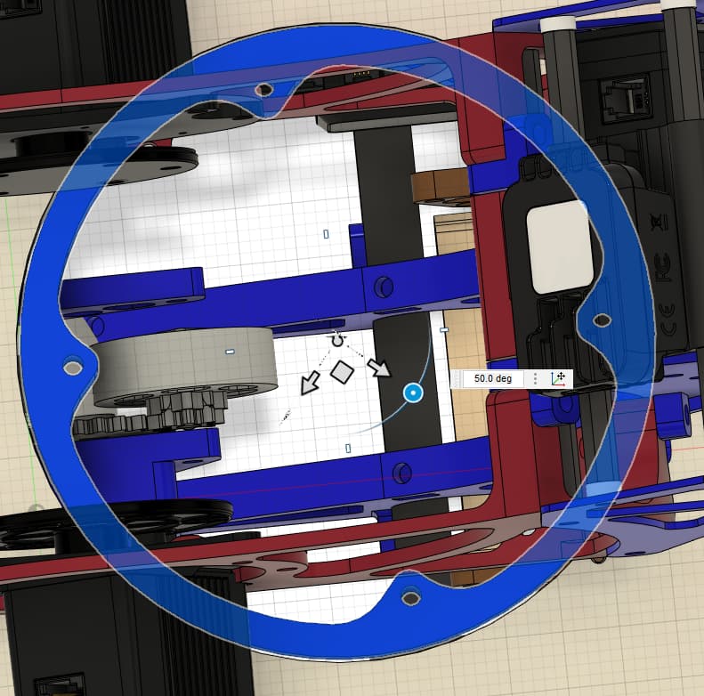

  • The turret is built to minimize the dead space between the last intake roller and the flywheel, to do this I decided to stack the turret powering and bearing assembly radially instead of vertically, unlike what you normally see. To accomplish this I had the bearings ride on the outside of a belt around a big 3D printing timing pulley (More images in the google photos album):
  • To minimize the space the flywheel took up, I chose to directly attach the output of the motor to the internal v5 motor gear, which spins at 3600RPM. Because the only thing holding this tiny gear in is a thing Delrin bushing, a also internally put another skateboard bearing around that gear to support it:
That’s about everything that might be sneaky, I’ll say it is a huge pain to get the turret together though since you have to space the bearings that it rides on out, hold the belt tensioned, and screw down the top plate at basically the same time.
Some other misc. information that will be helpful:

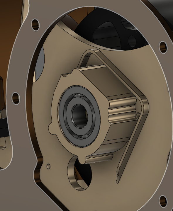

  • All the screws and hardware on this is 6-32 button head machine screws EXCEPT for the intake screws, which are 8-32 Socket Head screws I believe.
  • Everywhere there is a ~0.375" or ~0.5" hole on a rotating part is where I put a press-fit nylon spacer into a 3D printed part to act as a bushing.
  • You will almost definitely have to mess around with tolerances to get these parts working on your printer. The motor mounts and hood angle changing mech are super finnicky.
Some things that I would suggest you actually change from my design:
  • First and probably something you 100% should change is the size of the bearings inside the flywheel motors. Find ones with a larger internal diameter and adjust the adaptor to the flywheel accordingly. I say this because the one I have on this robot has exploded 2 times after ~10 hours of use because it has very thin walls and is under a lot of stress while shooting. Even another 2mm of ID would do it wonders.
  • Design better Flex wheel holders for the intake, I did this super lazily and basically it is the bare minimum to work well enough for me to not care to upgrade them :stuck_out_tongue:
Other than that, I can’t think of much else to tell you about this. As mentioned before in this thread it uses a Raspberry pi 4, though you could use a 3b, or even a OrangePi to accomplish the same things I’ve done here.
Let me know if you need any more help, I will try my absolute best to respond quickly.
OH one more thing I forgot to mention in this, the bottom retaining part for the turret belt/bearings was originally made with polycarb but it was way too weak so I changed it out for a milled1/16th aluminum part.

The thing preventing this on older versions was the velocity imparted on the ball by the robot driving around causing the ball to arc differently through the air and miss the goal. To account for this, it now calculates the trajectory of the ball with those additional movements and aims the turret accordingly. Here’s a video of what its like now:
I believe that this is actually the end of the project since the current limitations of improving it involve using a camera with a bigger FOV and adding motors to the turret to reduce the acceleration time and allow for a heavier flywheel.
If anyone has questions about how I made this work going forwards, feel free to ask here or DM me on discord (username: _zach_m). I’ll also update all the code on a the Github within a few days once its cleaned up.
