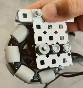

(Traditional Odometry Wheel)

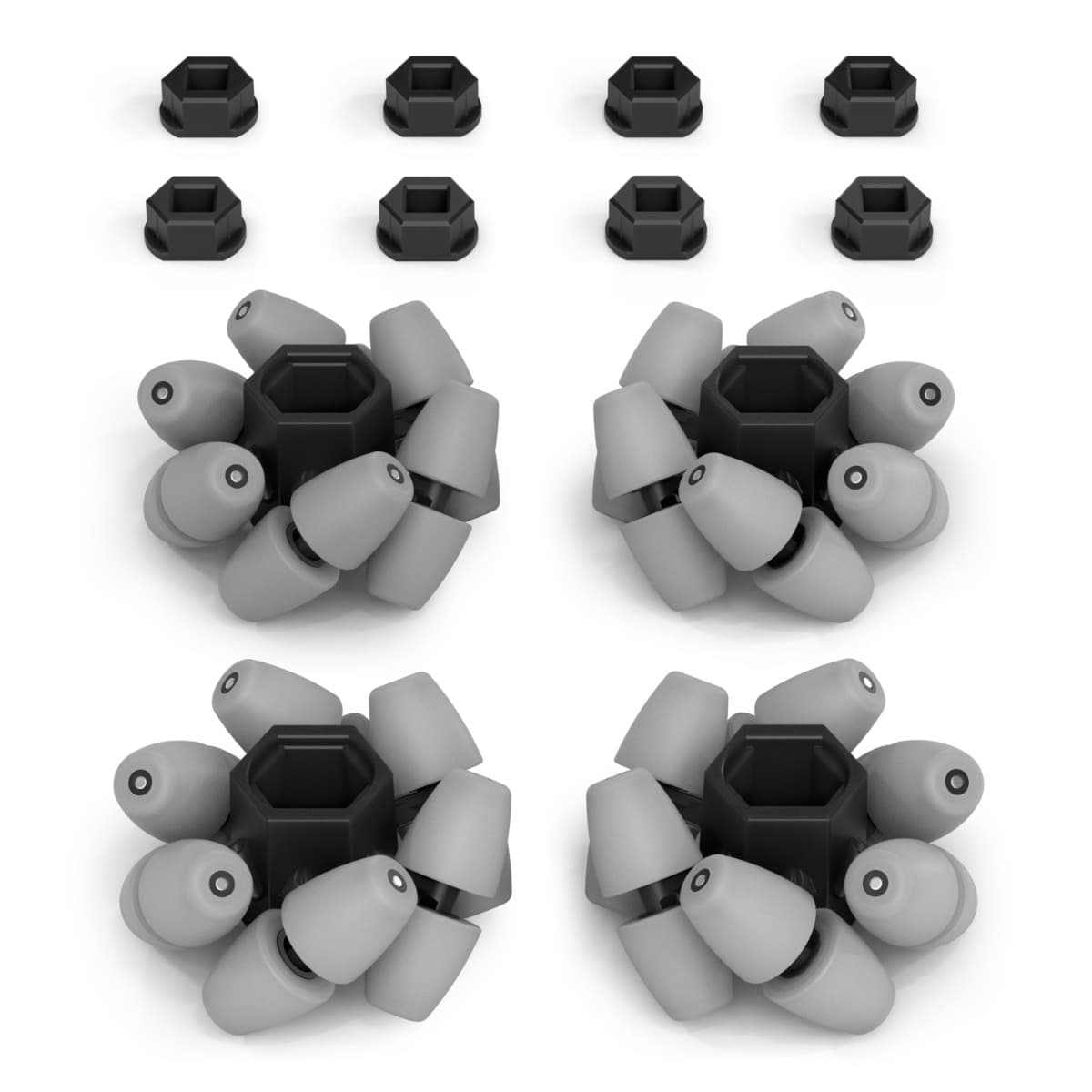

If my team was to ever build Holonomic Drive again: what would be the most Efficient design? I have seen many odometry systems with Omni-Wheels but I also wish to track sideways motion. This lead me to the 2" Mecanum Wheels.
(2" Mecanum)
They can go sideways as well. Could a Program be made to track both Forward and Sideways Distance with One Mecanum Wheel?
(Additional Image)
I am Interested to see your Thoughts. Thank you.

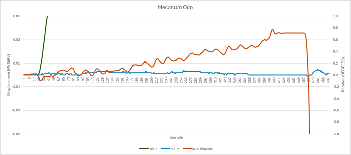

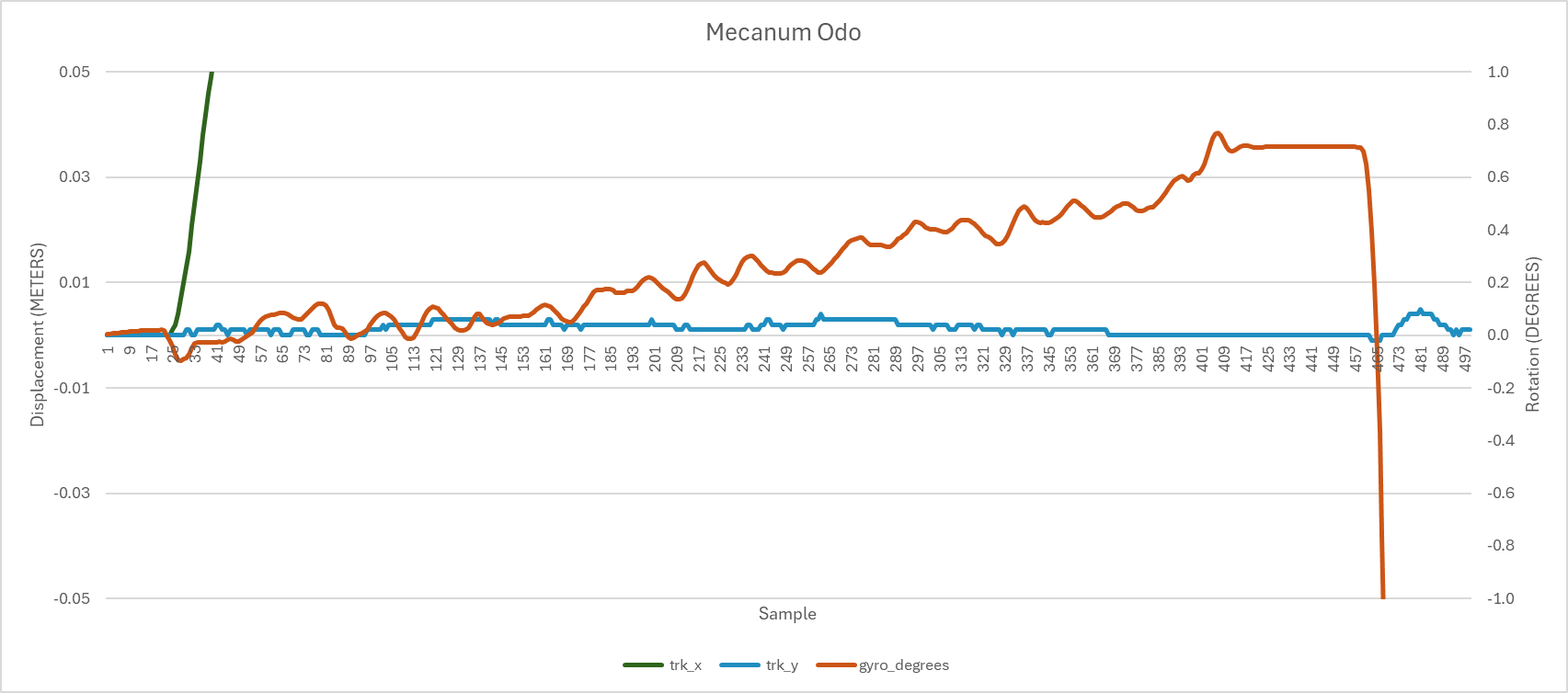

Now does that translate to detectable motion artifacts? Here were some readings - admittedly I don’t have these for regular wheels to compare. First graph is driving straight forward for 1m (positive x is field north, positive y is field east and heading is 0 deg north). At least there is negligible y displacement, but you can see the gyro picking up a distinct swing motion.
So at least on a straight trajectory this setup seems to do a reasonable job of mechanically cancelling any non-linearities between the wheels.

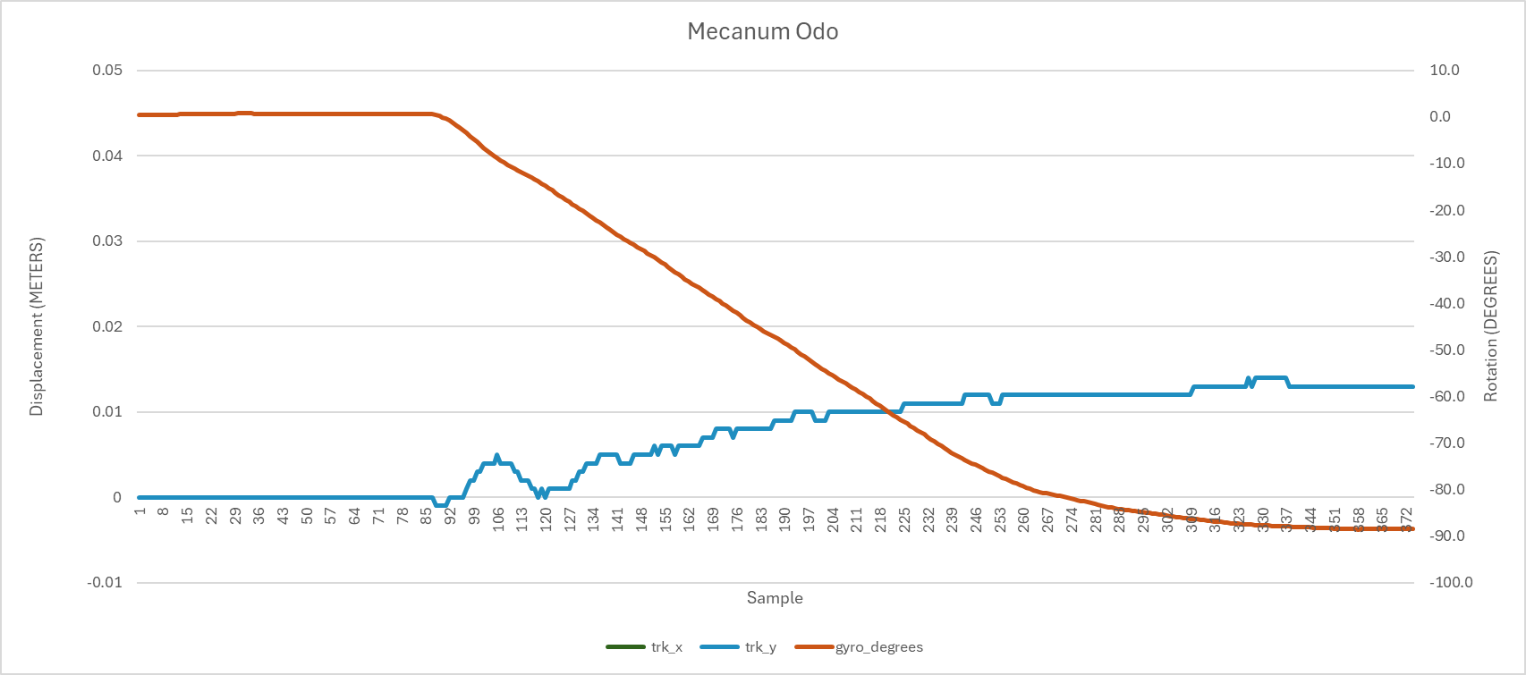

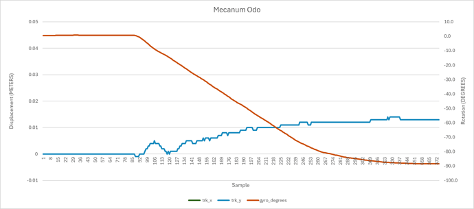

Rotation is a different story though. Below is what happens when the robot subsequently turns to the left by 90deg. x is too large to display here, but we drift east by about 1cm. Running several full turns you can easily see the robot drift quickly off its start location.
This was taken with 4" mecanum (note the gray PRO ones, so not VRC legal that i know of). I only have the older 2" mecanum - did not run tracking on those.
