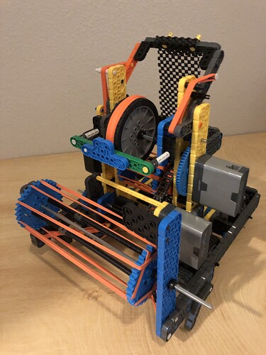

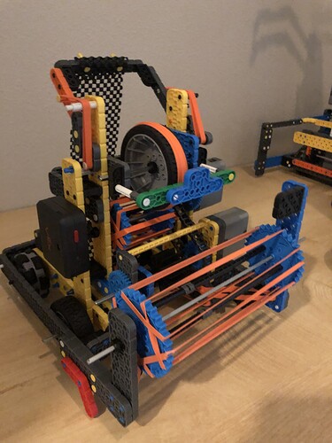

Finished a single flywheel bot today. will send photo soon
proud to present Klay junior
specs: 1:15 speed flywheel (although i think 1:12 would work too), 1:1 indexer, 2:3 2m drive.
The front roller has not been connected to the indexer yet
This does feature a lot of illegal parts like vrc intake rollers and non slip mats but they can be swapped out later for viqc legal things like hexbug plastic sheets to mimic lexan
The flywheel hood is rubber banded in the hope that it can go under the low bar but it cant and thats a really big bottleneck of this design. If anyone else is planning to make a flywheel bot, i would recommend a double flywheel because its more accurate and is less tall, like Joseph973’s flywheel bot
That’s adorable, you definitely nailed the mini-NbN look!
Robot WIP
To make it legal, you could use rubber bands instead of the slip mat like in 2616J’s turning point reveal: 2616J Mid-Season Reveal
The vrc intake rollers could be replaced with tank tread with flaps. You also have 2 more motors to use for hanging, and I bet you could do something similar to how some change up teams released their hood, with a ratchet off of the flywheel or indexer to retract it. Looks neat though!
I also wonder if, due to the squishy nature of the balls, tread would work better than rubber band rollers.
