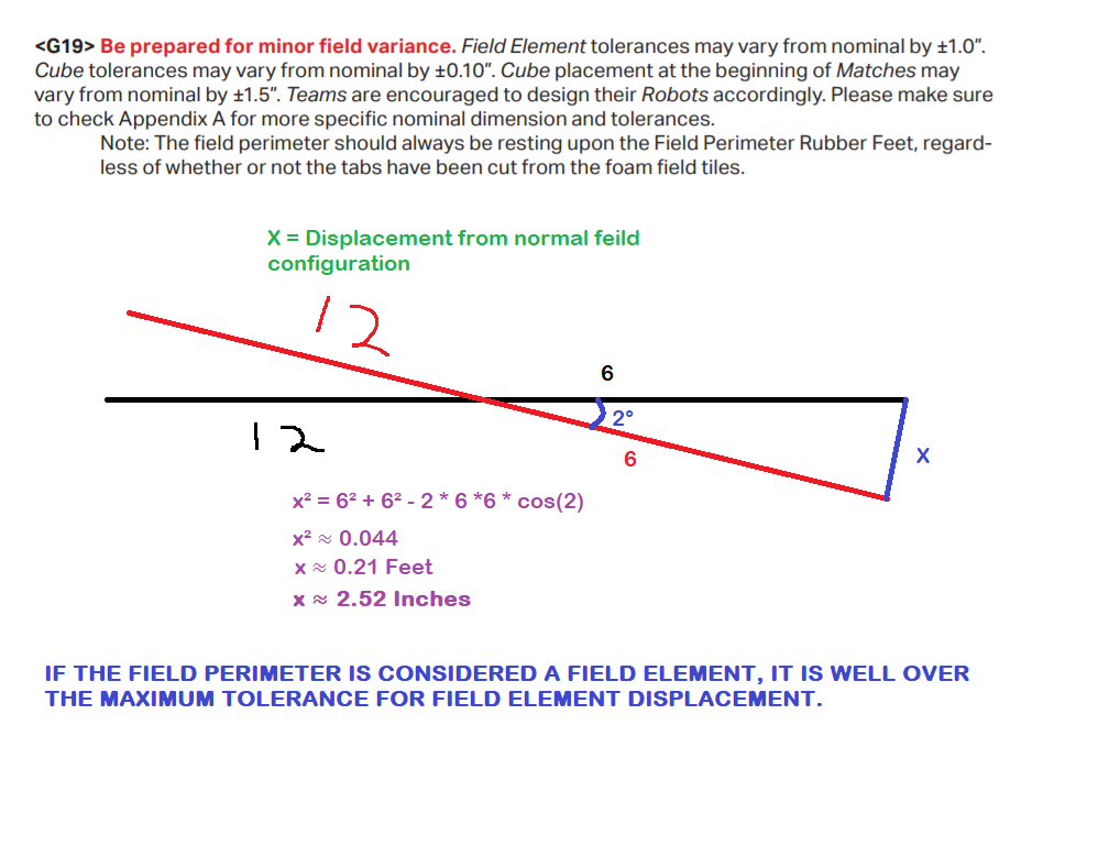

I did some calculations, @lacsap, and it would appear that per game manual rules, the fields are out-of-spec.
Virgina States Fields
Thanks for your interpretation and analysis - however, there is no mention of ā€œnormal field configurationā€, such as concrete floor that might not be level to what you consider ā€œnormalā€
So, let’s consider a non-zero hypothetical - an event on a cruise ship (actually a real suggestion for a particular EP), should the event be canceled if ship lists?
Also, in the diagram you provided was less of a change than in Skyrise faced by QCC2…
Back to my point - why change field if it was equally disadvantageous to all teams? (logic presented to the winners of Worlds during Skyrise - they had to adapt)… So are team no longer able to adapt?
