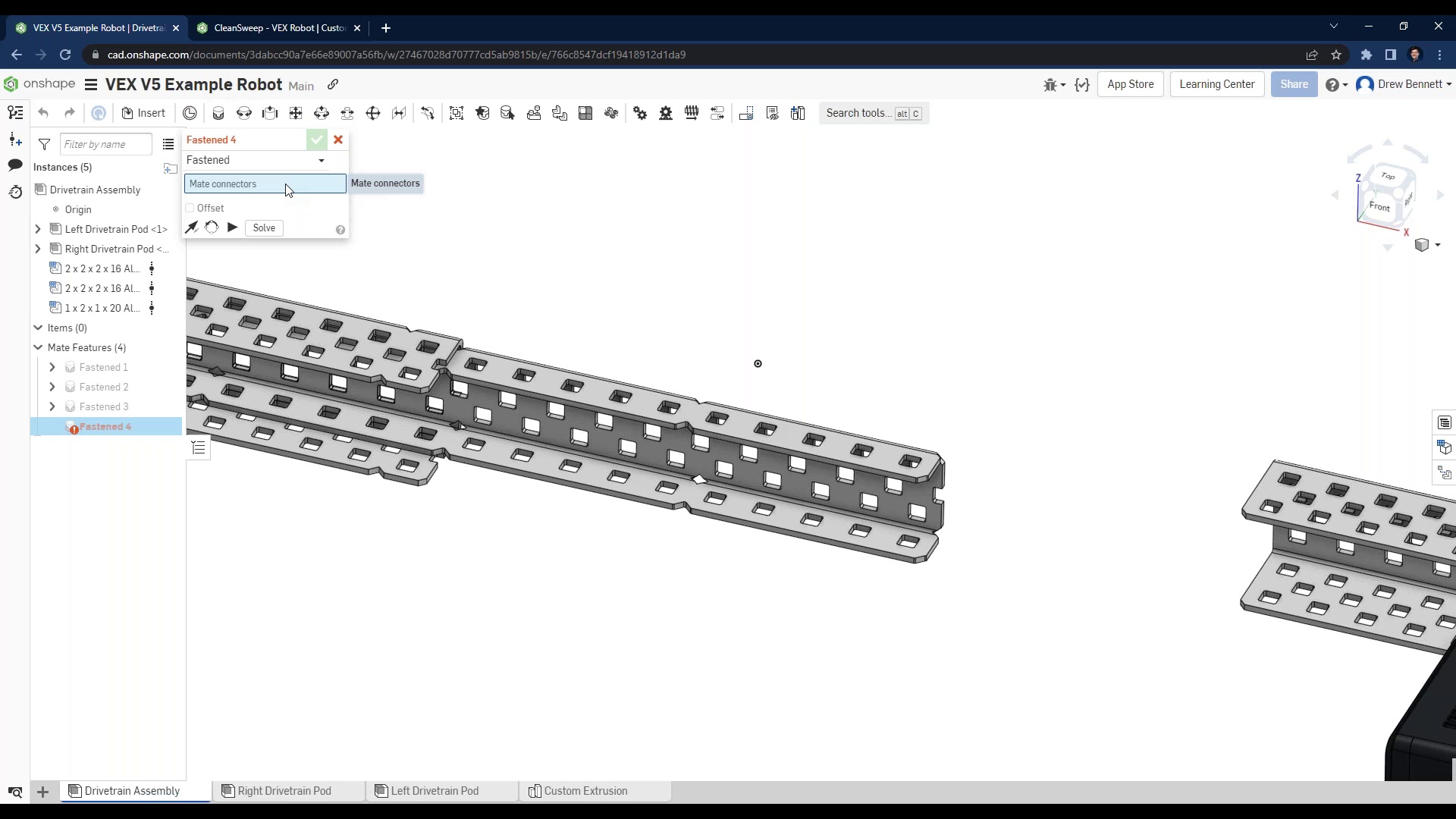

To aid teams who are designing their VEX robots in Onshape, the PTC Education team has released a VEX parts library. This library consists of 13 documents organized by the type of part. It contains many of the most common V5 parts, including all of the parts present in the Competition Super Kit. If you’d like to use this VEX V5 parts library in your workflow, you can check it out at this link: Official VEX V5 Parts Library

Is there going to be an IQ parts library soon? The current one, or at least the one I’m using, seems to be all surfaces, so when you animate a four-bar, for instance, the beams don’t hit each other and stop, they just go right through each other. That makes it harder to pick up on when there is a real problem with the design.
We can certainly look into making a VEX IQ library if there’s an audience for it!
Almost all CAD software will allow you to place two parts into the same volume of space, though some do offer a sort of “collision detection” for situations like you describe - it’s far more resource intensive to check for part collisions as parts move. Onshape doesn’t currently have this feature implemented. You can set rotational/slider limits and run interference checks on parts once they’ve stopped moving, though.
No parametric CAD that I have used (SolidWorks, Inventor, Catia, OnShape) has this feature as you describe it. To restrict motion, you set up what is called a “limit mate” where, for example, you specify the allowable angle of rotation, or the limits of a distance motion.
