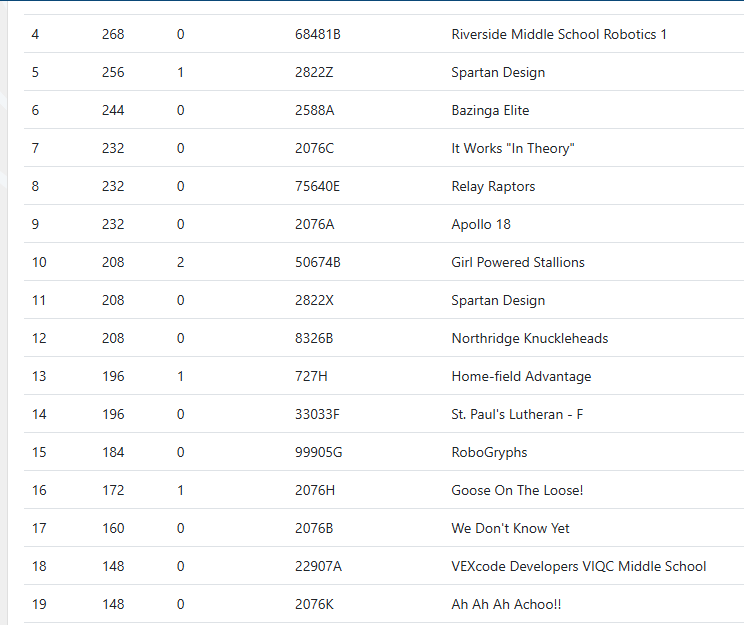

I have attempted to submit a skills score of 196 points with a stop time of 2 seconds. vr.vex.com lets me submit it, but it is not updating on the Virtual Skills Standings.

@BananaPi Were you able to find out how some teams have crazy max scores of 340+ in VR Skills for Rapid Relay. Rapid Relay does not give any options to customize gear ratio or 2 ball loading (unless I am missing something). without such customization, I am wondering how some teams can score over 300+ in Rapid Relay VR Skills.
Response to clear my understanding how VR Skills work, will be appreciated. Thanks
Yea my team managed to get 232 but can’t figure out how it’s possible to even beat that.
Try lookning at youtube videos for some high scores (like, 304+) it’s mostly just tweaking every distance untill it is juusstt far enough to score. Also, odometry with only the motors may be possible. If so, you could control each side of the drivetrain and be as efficient as possible. However, make sure you don’t let the Virtual Skills take up all of your time with the robot (I wish I learned that earlier). It’s a great way to use up time!
