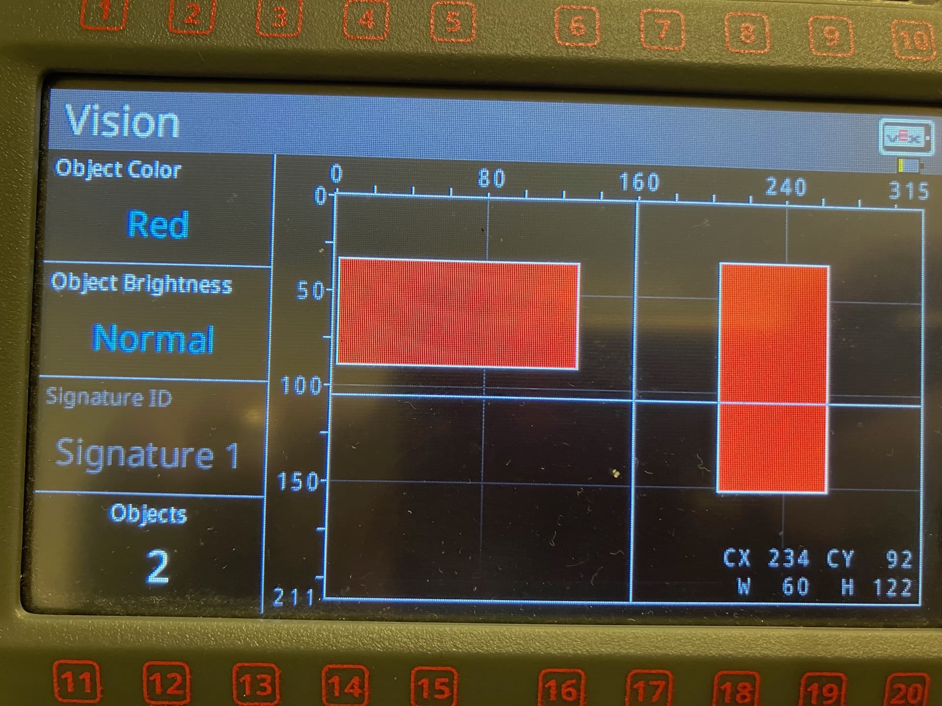

With a Vision Sensor plugged into a V5, the “Device Info” screen allows you to see a real-time view of the objects it detects in Red/Green/Blue/Yellow. If you haven’t see this, it’s really very cool!
Would it be possible to add to the VEXcode Vision Utility the option to set SIG_1/SIG_2/SIG_3/SIG_4 to the same Red/Green/Blue/Yellow settings that “Device Info” uses? (please)
Around this time each year, I attempt to use the Vision Sensor with my ~90 Intro Computer Science students… Exploring Image Processing and creating algorithms based on visual data is exciting. However, this can be challenging, frustrating, and disheartening for students trying to endlessly tweak the color signatures. The complications increase with the vision sensor on a moving robot adding significant variation to what the camera sees.
If the color signatures matched the built-in ones, there would be an on-the-spot way to view what the camera is detecting. Plugging the camera in via USB and using the Vision Utility helps students understand what is being seen/detected, but the robot is not always within range of the USB-to-computer cord length.
you can always bring up the dashboard while the user program is running and then it will show what is being detected with signatures set by the program (the Signature ID button will be enabled to select between them) The defaults for the dashboard when code is not running I posted here
