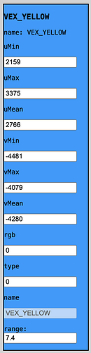

So, I created a very rudimentary solution for myself to use with students, and wanted to offer it to others:
This allows you to manually adjust the vision sensor properties within a V5BLOCKS file.
If students are struggling to set a good color you can use this to modify the signature with known good values.
@jpearman Can you share some insight on the “rgb” parameter in the v5blocks file? The vex::vision::signature does not use it to instantiate one. Is it in the file just for convenience?
[quote=“dczechowski, post:4, topic:112582”]
This allows you to manually adjust the vision sensor properties within a V5BLOCKS file.[/quote]
This is round-about solution until VEX allows blocks to set the color values.

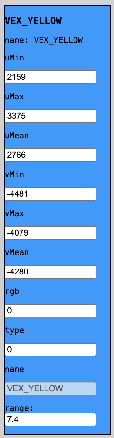

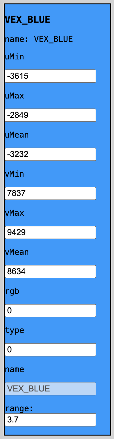

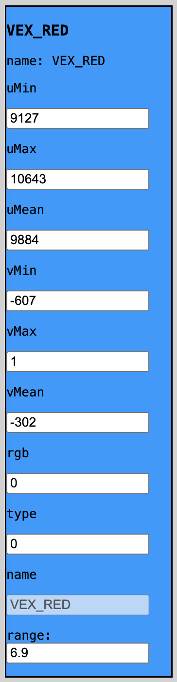

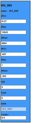

Here are the VEX default color values using this tool:
